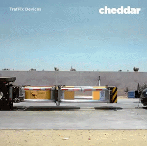

Came across this on Instagram.
Basically designed to provide roadside workers (and car passengers) extra protection in cases where a truck has to be stopped in a traffic lane to carry out some work.
Called the Scorpion TMA (Truck Mounted Attenuator):

Manufacturer : Traffix Devices
