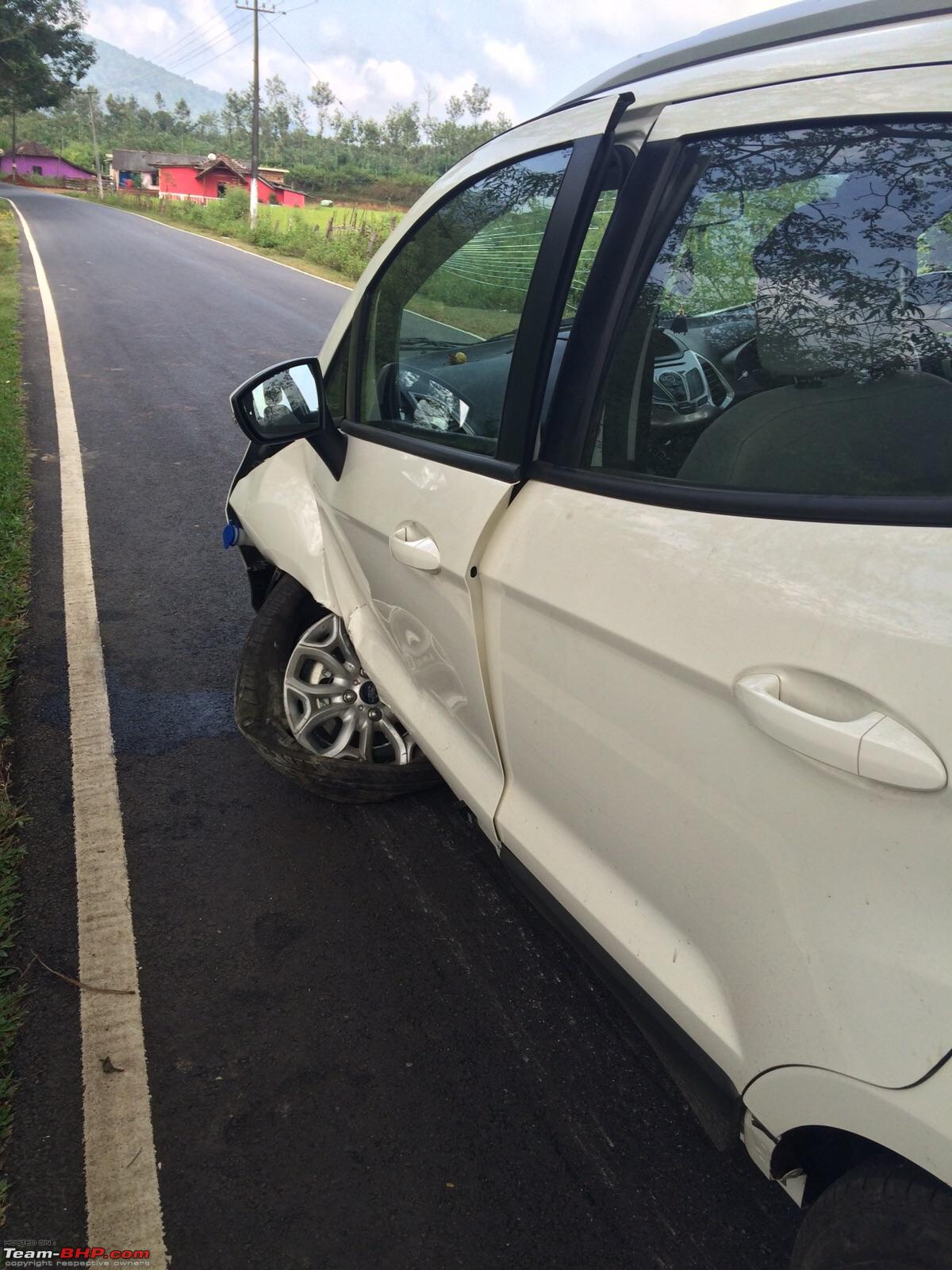

Actually the surveyor's observations are not very accurate either. As a layman, we figured out these a few posts ago.
One of the observations by Mr. Shetty.
It is supported by a bent forward backrest of Co-Passenger's Seat (front Left) due to impact received from a unbelted passenger on rear left seat.
In the following initial batches of photos, the passenger seat is in the correct place and not bent forward as mentioned above.
Initial pictures
http://www.team-bhp.com/forum/attach...1101wa0027.jpg
http://www.team-bhp.com/forum/attach...1101wa0026.jpg
Whereas the picture from the service centre as uploaded on FB, and the basis of his observation
http://www.team-bhp.com/forum/attach...61429057_o.jpg
Again his observations would be based on what is shown to him. In this case, the condition in which the car is shown to him.
It may not necessarily be the condition in which the car was brought in.

The very first image of the first post makes me want to believe the owner's version of the story (unless its not a photo shopped image ). How can the car hit a culvert, sustain so much damage, burst tyre get back on road and still travel in straight line? The skid marks indicate that though.
Very good points given by the surveyor, but is it possible that the evidence may have been contaminated? The car was towed and taken to the service center. In this process or while car was resting in service center, anything could have happened.
Did the same surveyor visit the accident spot? If he did, did he or anyone else who visited the spot notice any damage on the culvert being spoken about? With the experience he has, if he had visited, am sure he would have noticed and taken pics. The culvert may still be in damaged state even now actually if anyone happen to take that road.
Whats more baffling is the off duty surveyor has concluded the case too. If he was on duty surveyor, its understandable due to targets or any other pressures.
What was the hurry here to give such a clean chit to manufacturer as well as being so sure that a sleepy driver caused it.

1) This model has 6 air bags, why none deployed? Was it since there was no direct impact on the body which impact sensors could pickup? Where are the side impact sensors placed for curtain airbags?
2)Did the axle break as designed, to create a crumple zone and reduce impact to the occupants?
3) Why did the alloy shear and not break starting the outer wall point of impact? Did it shear due to the dragging motion, think so.
4) The culvert wall on left side looks to be outside the road edge (or is it an illusion)? On the right side, it is clearly inside the road edge
5) The cement piece inside the tyre looks fishy....right after the (proposed) high velocity impact, the tyre side wall bursts, throwing the air out at high velocity...at the same time, a piece of concrete gets in through there?
6) Seat forward point is not valid, as a lot of BHPians here pointed out.
7) The ecosport seems to be quite a stable car, even after such a mishap, it managed to hold its line.
8) A quirky query: If the vehicle wheels are in the air(rotating), and the brake slammed, ABS in action, will the wheel lock or not?

I tried to see what happens when a car hits a culvert at speed and the closest video I could find is the one below:
Fast forward the video to around the 7th minute and play it from there (7m18s to be precise). If you look at the end result for the car and compare the end result with that of the EcoSport, they look very similar - although the EcoSport appears in a much better condition mainly due to the speed and forces of the accident involved.
I'm speculating that the driver had turned the wheel towards the left (notice the curve on the road) and in doing so, managed to hit the culvert on the left by mis-judging the space on the left. This explains why the bumper seems to be so lightly damaged while the wheel took the full impact of the culvert.
This impact could have caused a deformation in the tyre and could have compromised its strength, specifically, the sidewalls. As the tyre manufacturer has already mentioned in their report, the tyre has burst (due to the impact) and this resulted in the axle/brakes/wheel rim assembly hitting the ground.
When the driver probably realized whats happening, (you travel 40ft in one second when you are going at 40kmph and its clear from the pictures the car has moved at least 80 feet from the culvert), he tried to steer to regain control of the veering car and this may have caused the alloys get wedged against the road surface and eat into it. Again, at speed, the shearing forces caused the alloy to tear and BITE into the tyre and finally causing the vehicle to grind to a halt.
The rest of the damage with the tie rods and drive shaft connectors, etc. seem to be a consequence of such massive forces acting in a short span of time. As far as the LH trim behind the wheel damage is concerned, it could have happened either a (A) the culvert itself or (B) the rims bending and hitting the LH trim.
Again - all this is a speculation.
I'd imagine so. The wheel broke away, therefore absorbing some of the impact, and therefore transferred less to the body-mounted airbag sensors.
From what I've seen, the axle hasn't really broken. The CV joint has just popped out from the engine side:
Ford EcoSport - Axle breaks on highway. EDIT: Due to accident (details on page 11)-img20151101wa0029.jpg
This is what an axle looks like:
Ford EcoSport - Axle breaks on highway. EDIT: Due to accident (details on page 11)-saab_95_00_cv_front_axle_shaft.jpg
source
The physics of it don't sound fishy to me, though i was surprised it was still in there (at the service station).
Fact is, even without this piece of cement, the additional pictures told enough of a story.
Newton's first law. An object at rest stays at rest and an object in motion stays in motion with the same speed and in the same direction unless acted upon by an unbalanced force.
ABS will function similarly, however, the brakes now only have the rotational force of the wheel to overcome (since the road isn't applying any force). This means that even if the ABS is pulsing, the brakes have less resistance against them, and chances are the wheel might stop spinning. I'm talking about a non-driven wheel here.
Can't say the video is similar to what happened here. In this case, the wheel clipped the culvert whilst running almost parallel to it. In the video it's hitting it almost square (though by definition that is also an "acute angle" )
The bumper would have grazed the culvert, but the edge of the tyre & wheel would have taken a more square impact. Even a tiny overlap could do this damage:
Ford EcoSport - Axle breaks on highway. EDIT: Due to accident (details on page 11)-2014_ford_ecosport_b1.jpg
And once again, look at how much the tyre sticks out further than the front bumper:
Ford EcoSport - Axle breaks on highway. EDIT: Due to accident (details on page 11)-newfordecosport759.jpg

Good point Vinit, that observation was indeed wrong since we have evidence to prove other wise.

Of the two plausible causes regarding the accident
1. Due to axle giving away.
2. Due to external impact.
With the evidences available to us, photographs and a reasonable analysis from a surveyor one can conclude which could be the plausible cause for the accident.
For me, the plausible cause would be most likely due to an external impact.
I had an accident few years back when an indica hit my car, the front right wheel took the brunt of the impact and the lower wishbone was bent not as bad this ecosport.
Here is the details of the accident
Ford EcoSport - Axle breaks on highway. EDIT: Due to accident (details on page 11)-image1412.jpg
And regarding the explanation given by the driver, from my personal experience, mostly it will be really hard to know what exactly happened. In the above accident, I went the next day to the accident spot to do more investigation, that is when I took those pictures. It is then, I concluded that the indica would have hit me at 90 degrees. All I could remember was seeing two headlight coming towards me and I turned to the left, but I was looking towards the left side of the road by then.
Originally Posted by drpullockaran View Post
Looks like somebody with intimate knowledge about vector of forces and subsequent trajectories need to assess this incident
Ah, debate between theoretical knowledge Vs Practical experience. But in this case, I believe it will not matter much. More photographs from the accident scene would be more helpful. Especially of road with the marks from the broken alloy wheel.
