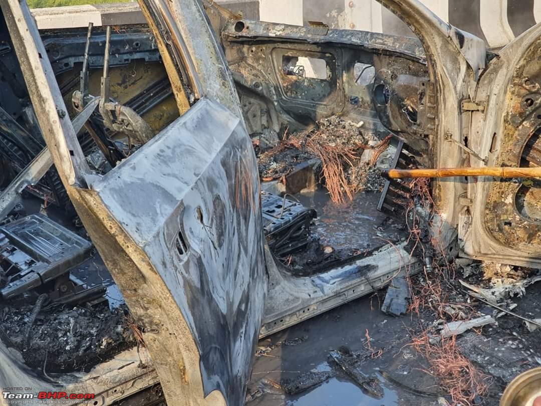

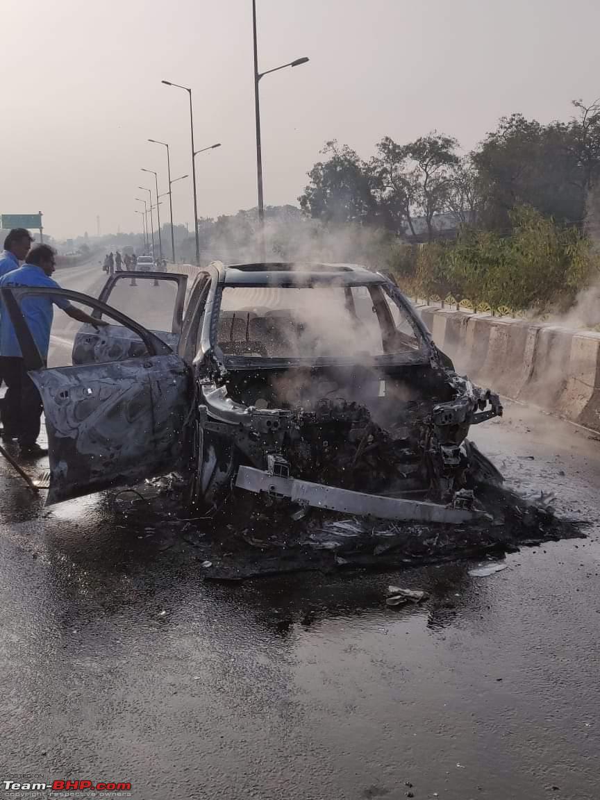

I came across a post on Facebook by Rakesh Patel where in his 2016 Volvo XC 90 caught fire.

I want to narrate my almost near to death incident which occurred day before y'day (13th Feb '20) while I was driving to Ahmedabad, GJ from Vadodara, GJ in my Volvo XC 90 car.
Local news clipping: https://www.Youtube.com/watch?v=soKk...ature=Youtu.be
Details about my car: Car tag: GJ06JQ1114; Model Year: 2016; Total kms on the car: ~ 52,000 kms
Details of my incident: In the middle of the journey, the engine warning light flashed on the odometer out of the blue. Due to my extra diligent nature, I decided to pull over and inspect what the triggering issue was. I also asked my daughter and wife who were accompanying me on this journey to step out. Before I could even check anything, the car started fuming and flames started gushing out of the car’s bonnet in a matter of seconds. We’re shocked to see what unfolded and ran away from the car in order to save ourselves from grasp of death.
As helpless as we were, the first and foremost thought that hit our minds was that what if we were in the car and what if we were not over precautionary in our approach. I couldn’t thank god enough for saving me & my family’s life. Upon returning home, I couldn’t stop wondering as to how the “World’s safest car” could turn into a death machine.
Then I started reviewing my data (wherein all my service records were up to date and never was anything flagged to me). With that being the case, I started researching online to see if something like this had ever happened before. Turns out, the Volvo engine issue has been widely talked about and acknowledged by the company as well. Reading that I’m gutted to know as to why my car wasn’t flagged and how Volvo India’s negligence could’ve costed us our lives.
A Very Dejected and Disappointed Ex-Volvo Customer

Volvo recalled 5,07,000 cars globally due to a risk of fire in the engine bay in 2019. (Link to news). All the cars affected are powered by a 2.0-litre, four-cylinder diesel engine.
The affected models include the S60, S60 Cross Country, S80, S90, V40, V40 Cross Country, V60, V60 Cross Country, V70, V90, V90 Cross Country, XC60, XC70 and the XC90.
It is said that the plastic engine intake manifold in the engine bay could melt and ignite a fire. The symptoms could include an odour which is not usually present while driving a car, engine interruption, illumination of the engine warning light, and loss of power. Drivers should then pull over and call Volvo's recovery service.
Volvo is said to be contacting owners of the affected cars but it is reported that a complete solution to the issue has not been found yet.

My Volvo S60 (2017 model) was recalled a few months back to change some components inside the engine bay.
Being curious as to what exactly is being changed I ventured onto the service floor and asked the mechanic what part was he changing.
Apparently there is some fuel line with a plastic part which is likely to catch fire.
This was the part that was changed.
Could it be that this XC90 was also supposed to be covered under this recall but somehow wasn't worked on in a timely manner?
