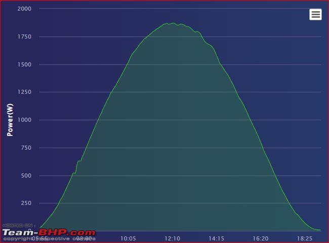

Hi SK, just a quick question. What is the generation capacity % during cloudy weather or when the panel is not under direct sunlight (e. g. shadow on panels)?
Currently, it is dark, raining in my location, generation is 250 to 500w. In general, I see that the generation from 16:30 to 18:00 varies between 600w to 200W (in a 3KW system with 9*330W poly panels), this is when the light starts to fade and a shadow is cast from an apartment complex in the vicinity.
In general, the system will be viable if you can have no (man-made) shadow from 9..10am to 3..4pm. Attached is a snapshot of generation on a typical summer day (Jun/07). It reaches 1000W by 9am and crosses it backwards at 4pm.
