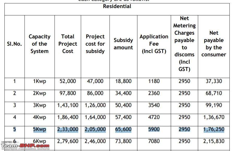

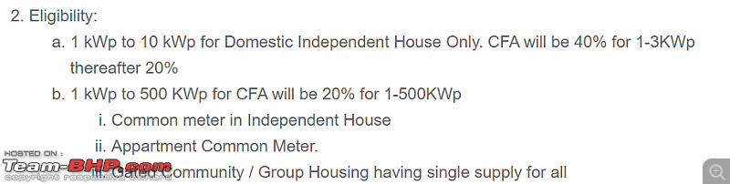

Some insights into the Govt subsidy for anyone interested. Long post warning!!!
The subsidy is partly issued by the center and the rest by the Renewable Energy dept (REDCO) of the respective states and is different for different types of customers.
Attachment 2188040
To avail subsidy, one needs to get the solar plant installed by a registered empaneled vendor. The list can be found in the website of the REDCO of your respective state. I believe, MNRE has assigned the responsibility of processing and inspecting the installation to DISCOM of state (atleast in Telangana), so in TS, you find the required list in the DISCOM website.
The empaneled vendor is responsible for end to end processing and installation of the system. The customer pays only the subsidized amount and the vendor has to claim the subsidy directly from the DISCOM or Renewable energy Dept(REDCO). DISCOM does inspection before installation and approves the application and Installer needs to install the system within a stipulated period and submit completion documents to the DISCOM. DISCOM will inspect again and once satisfied, will install a Bidirectional Netmeter in the place of your regular meter. The meter takes care of the Import vs export of Power. In TS Exported units are credited as balance Units and you can use in the consecutive months. They settle any left over units twice a year at a predetermined price (2-3 Rs/unit)
Mind you, the subsidy is not on the quote that the vendor gives you, but it is on the benchmark price that is determined by some committee of REDCO based on bids received etc. This benchmark price for 1 KW system is approx Rs 47000. See table below for subsidy offered in TS based on size of system for domestic customers.
Attachment 2188047
That said, the ground reality is far off from the Benchmark pricing. For a system that is supposed to last 20+ years theoretically, companies cannot really offer a good quality system within the benchmark price and that is why the quotation that the customer gets is much higher than the benchmark price.
Usually, this also includes elevated structure (that most customers want to save space on the roof top), better quality cabling, better Balance of systems, Better inverter quality etc. etc.
