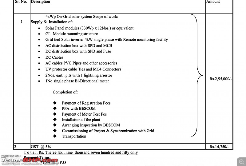

Thanks all for a very informative and detailed discussion on this topic. I have been exploring the roof top solar panel option in Bangalore. The quotation I got is attached here.
Solar power! Turning my roof to a power plant-c0987674475849039b98ab1ad3e9f375.jpeg
This is a poly panel and they are calculating a recuperation of cost over 5 years at my current usage.
Is this a reasonable? The company guys seem professional and communicative enough. I believe that BESCOM is now paying 3.99 per unit. The application was made under a subsidy scheme- though no details of subsidy has been announced by the government!
