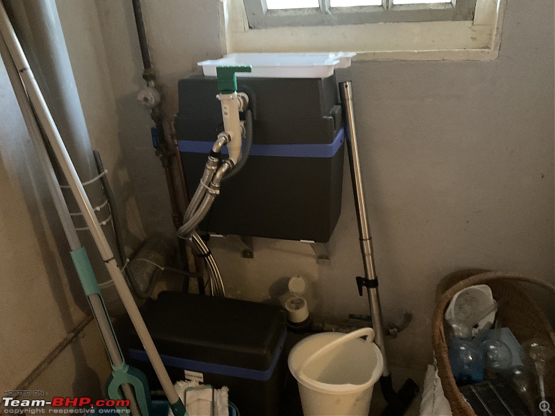

I just came across this thread. Just wanted to share my experience here in our home in the Netherlands. We moved here just under five years ago. It’s an old farm with several extension. Prior to us moving in we had a lot of work done. All three bathrooms as well as the two kitchens and downstairs loo were completely renewed. So we had nice clean new tiles, taps, sinks, shower heads everywhere.
Our water hardness is in the 7-8 oD (German hardness degrees). Which isn’t too bad really. But within a few years of use we noticed limestone stains everywhere that were becoming increasingly more difficult to remove.
So we decided to get a water softener. We use about. 2000 m3 of water annually. I did quite a bit research, had three companies come around. Finally we decided on a water pressure operated salt/resin based duplex water softener. Don’t believe any of the claims made on the magnetic systems. They just don’t work!
Although it is just my wife and me living here, we tend to have guest staying with us very often. If anything almost every week one of our kids/partner and grand children are staying with us. So I wanted a good capacity that would allow us to run two showers at the same time, no problem. I finally choose this one, a Dutch manufacturer. It was not cheap, Euro 2000 (INR 160000). For that they deliver and install the unit and start it up and I got three bags of salt.
This unit has a bypass filter which is really handy when watering our garden. The unit delivers water at about 1.6-1.8 oD. For various reasons you are not supposed to go any lower. I must admit it works really well. We use probably about half the amount of soap, detergent and shampoo, compared to before. Love washing my cars with it. Also, I do the hosing down of the woodwork on our house as well clean all the outside windows myself now.
We have had it for about 8 months now. The lime scale that had built up is slowly diminishing as well. The unit, in particular the resin, needs servicing every two years. You could do it yourself. Certainly the first time I will get the service engineer and watch him do it. This thing is supposed to last at least twenty years. So expensive initial outlay, but we should be good for twenty years.
With full duplex we always have soft water. This unit just uses less than 20l to flush and regenerate every 1000l of water. So very efficient.
Seems like a good buy, for what it does. I wonder if it will work with Indian hardness levels, often 50+ °D. Price is honestly worth it. Does it come with its own pump to pressurize, or is it completely passive? Also, can you share the name / link to check if it's available globally.
