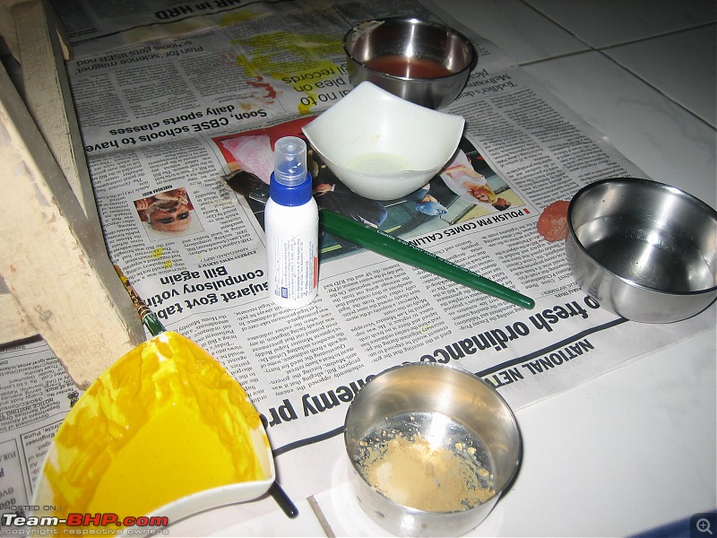

Preparing yellow color- boil some water and take a small quantity in a container. Start mixing turmeric and glue in it. Mix properly and make a paste. Remove the granular lumps if any by mixing it properly. You can see 2 brushes in the picture the bigger one (on right) is made of pony hair which I found a bit lousy to use as it did not hold firm and also formed lumpy. Liked the smaller (left) which was made of taklon.
How to make ganesh idol from Clay and celebrate eco-friendly Ganesh festival-coloring-equipment.jpg
