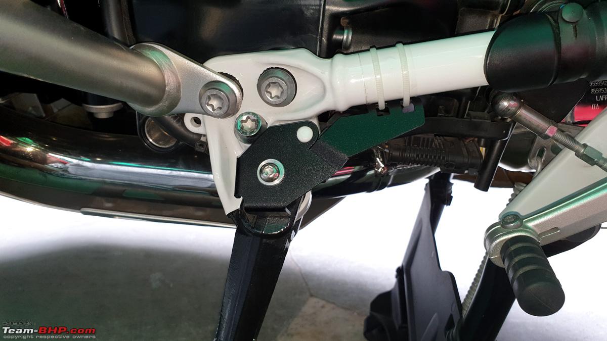

Received this Side Stand Switch protector from AliExpress
BMW R1250GS Adventure Pro MY2020 - Style HP - The Comprehensive Review-side-stand-switch-protector-24092020_1.jpg
https://www.aliexpress.com/item/4000...27424c4ducKiIn
This switch is a critical part which can render you stranded as the bike will not start if this switch gets damaged in the event of a fall or a rock hit, which was also mentioned by some other colleagues. Though there is a workaround by which 2 of the 3 wires (except the brown ground wire) going into the switch are cut and shorted to get you going, in case the switch gets damaged. Hence imho it's protection was essential.
This is a exact copy of the Touratech part which retails at 50$. Here's it's installation manual. I installed with the Type 1 installation instructions as shown in this photo, so only the longer M6 20mm screw and the washer was used, with blue threadlocker (Loctite 243). If you look closely, I also installed a little transparent tape to protect the white paint of the frame where the zip ties are attached.
BMW R1250GS Adventure Pro MY2020 - Style HP - The Comprehensive Review-side-stand-switch-protector-24092020_2.jpg
Before Installation
BMW R1250GS Adventure Pro MY2020 - Style HP - The Comprehensive Review-side-stand-switch-protector-24092020_3.jpg
After Installation
BMW R1250GS Adventure Pro MY2020 - Style HP - The Comprehensive Review-side-stand-switch-protector-24092020_4.jpg
Cheers...

Congratulations for your new Bimmer. Keenly await for your updates on the thread. Please keep posting :thumbs up
Small tip- instead of plastic zip ties you could try these SS ones at Amazon.in.

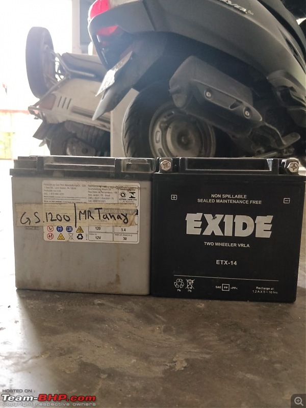

Well as luck would have it the shop at Karol Bagh has given up on trying to get a battery and have refunded the advance. Hence, this Saturday I'll head to Meerut and see what pans out (thanks for the contact).
Meanwhile I have found a few other options like a Varta AGM battery and Shido lithium ones which can be found in select superbike accessory stores in Delhi but they are all above the 10K mark.
I rode to Meerut this morning, facing extremely large jams in Modinagar and reached Vardhman Automobiles, got the battery for 3.5K with bill and rode back home. It was highly exhausting - now I remember why we start at 4 or 5 AM to go to Uttarakhand - to avoid precisely what I just went through today.
Anyway, here's the old and the new batteries side by side:
BMW R1250GS Adventure Pro MY2020 - Style HP - The Comprehensive Review-batt1.jpeg
BMW R1250GS Adventure Pro MY2020 - Style HP - The Comprehensive Review-batt2.jpeg
So I plugged in the new one and the bike is back to top form. I just did a small city ride to fuel up and it cranks easily, will report long term observations.
I am really pleased with this alternative to ripoff prices. I am going to use the (perceived) savings on some bike accessories now :D

Congratulations on the new battery Tanayr, if that calls for any celebrations... Lolz. Sorry for the traffic to Meerut. Yes, it's terrible due to the Rapid Rail Project coming up. In the future, if ever needed to go to Uttarakhand, take the route via Hapur as the new Meerut-Hapur-Bulandshahar Expressway is now operational. Longer by about 15-20 kms but your speeds will be in 3 figures, unlike the crawling traffic on NH58. Anyways, Delhi - Meerut Expressway should also be hopefully be operational by December, so that extra distance will also vanish.
You won't face any issues with the battery, but do keep updated just in case.

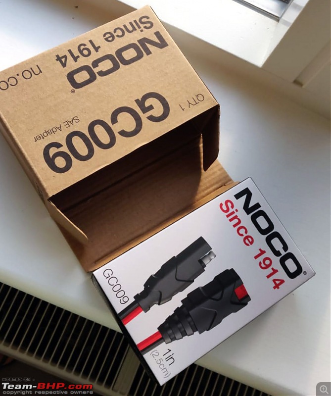

As the SAE adapter was missing in this setup, I searched online and found quality adapters available abroad but no one was presently shipping to India. As both my children were studying/working in Ireland, promptly ordered one from NOCO through Amazon UK at around a 1000 bucks. Pretty steep for a piece of wire but the quality seems worth it as I did not want any compromise in electrical connections. Landed in a day. The packaging was huge (waste) for the part it entrails -
BMW R1250GS Adventure Pro MY2020 - Style HP - The Comprehensive Review-noco-sae-adapter-bosch-battery-charger-26102020_1.jpg
https://www.amazon.co.uk/gp/product/...?ie=UTF8&psc=1
Here is the actual connector
BMW R1250GS Adventure Pro MY2020 - Style HP - The Comprehensive Review-noco-sae-adapter-bosch-battery-charger-26102020_2.jpg
The other end attaches directly to the Battery lead of the Bosch Charger
BMW R1250GS Adventure Pro MY2020 - Style HP - The Comprehensive Review-noco-sae-adapter-bosch-battery-charger-26102020_3.jpg
