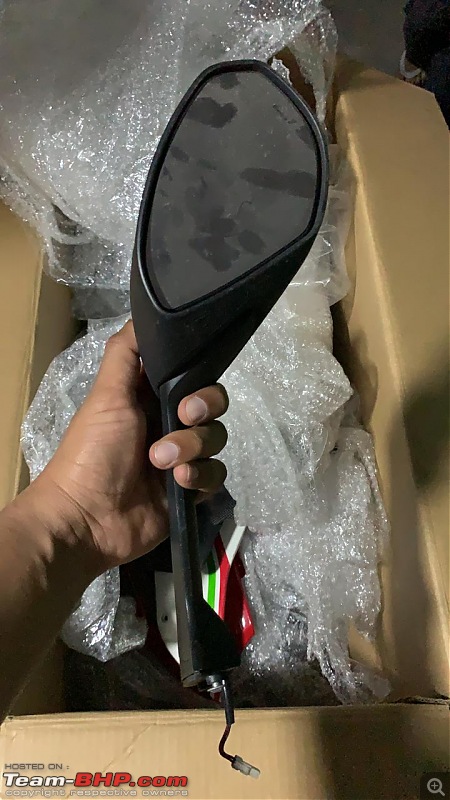

Bike mirrors - dusty but in good condition
How I saved India’s only Ducati 1199R | An unlikely find, revival and restoration project-whatsapp-image-20210222-9.35.49-pm-2.jpeg

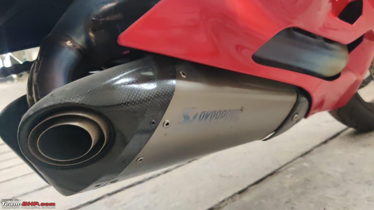

Akrapovic full system race exhaust with carbon fiber tips. These babies were ordered originally with the bike as additional accessory. The same ones are installed on the Superleggera. I kept them rather than the Termis as my V4S has Akra. Plus I like their look and sound ;)
How I saved India’s only Ducati 1199R | An unlikely find, revival and restoration project-img20210218wa0020.jpg

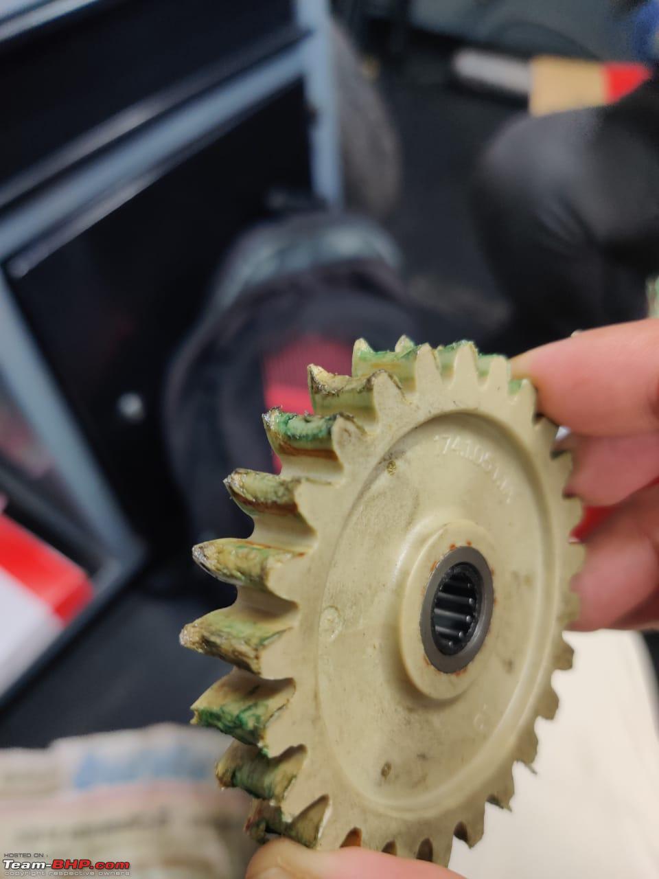

He told me that while the parts looked ok, water sat inside the engine, so he needed to tear down and rebuild the engine, check parts, replace a bunch of gaskets, adjust timing chain, make sure the valves work in sync, undo the mess the previous mechanic created, replace the water pump and do a full engine tune up until it returns to the factory specs. By his estimates, a minimum of 1 month is needed. I told him, no sweat, let’s work slowly and carefully.

In the meantime, we discovered something unique. We installed a new 1199 water pump, even though the old one was working fine (replaced like for like after we removed the old pump and ordered the same model just to be cautious). But the service tech, while going though the coolant schematics, discovered that the 1199R has a higher spec pump motor. So when the crash happened, the first technician removed the 1199R water pump and wrongly installed the pump meant for the 1199 base model. We did not realize that the two pumps have different power outputs. Once we caught this error, we then ordered the 1199R water pump from Italy and installed it. Now the collective light bulbs in our heads flashed.
The original water pump installed after 2014 crash and the one we installed, both from 1199. We took out the 1199 and installed the 1199R pump
How I saved India’s only Ducati 1199R | An unlikely find, revival and restoration project-img20210814wa0005.jpg
So what actually happened

Damaged water pump gears. The original water pump was changed but the gears were not. The water pump never worked properly and failed to circulate the coolant

12. Fixed the original Termignoni cans that got damaged in the crash - used pliers, hammer and arm strength to straighten out the damaged fixtures and bend into shape the brackets. There are still some scratches, but can be buffed / polished and the ends repainted. I won't use these cans so they will be a decoration piece at my house
