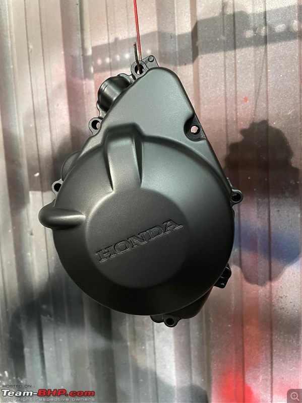

Engine case and fuel cap
A college dream fulfilled – Mark 13 – The Honda FireBlade 954RR-parts-condition.jpeg
After Repainting.
A college dream fulfilled – Mark 13 – The Honda FireBlade 954RR-restored-1.jpeg
A college dream fulfilled – Mark 13 – The Honda FireBlade 954RR-restored-2.jpeg
A college dream fulfilled – Mark 13 – The Honda FireBlade 954RR-fuel-cap.jpeg

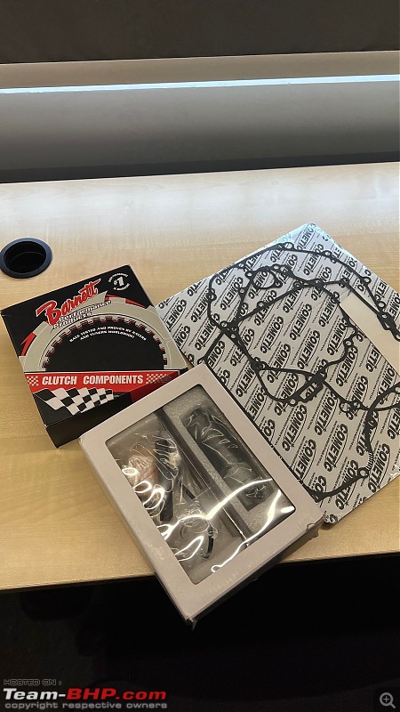

So from a decision of not making any mechanical change, the below was ordered, some from US, some from India and thus began my journey to make the the Japnese bike a truly global bike. Luckily few friends were coming so they got me this stuff.
So Round One
1. All Balls Racing Fuel Pump
2. Gaskets
3. Barnett racing Clutch
4. LED Healights
5. All Balls Racing Fork Seals and Dust Cap
6. LED indicators for Rear
7. Led Sit Flush Indicators for Front.
8. Halogen Philips Diamond Vision Light for the High beam.
9. Tank Grips
Here are the pics for your viewing pleasure
The first 3

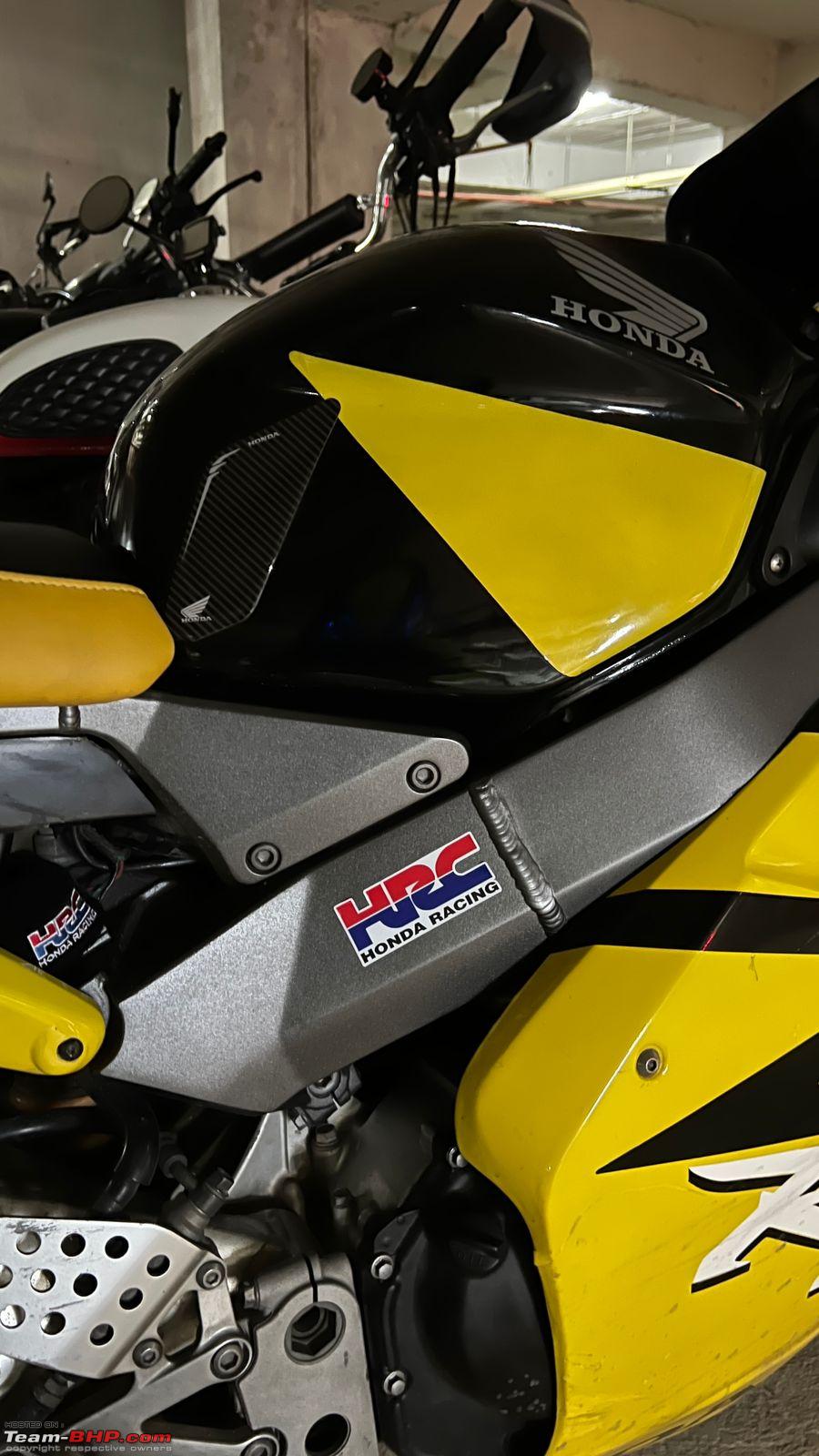

The Accessories!!
While the bike was at gargage, there were few things that were catching my attention regularly, and since now I had decided to buy more stuff for bike, I decided that let's go all in. My brother stays in switzerland, and it is easy for me to ship stuff to him and then he can carry it back for me. So I decided to order those parts from Ali express which I thought I will need, and I put a word to him to send the ones marked most important by me as soon as possible in case any of his colleagues was travelling.
So the most important things that I thought I wanted upgraded Immediately was the Headlight dome, the old one with it's life cycle had cracks in it. So I started scouting Aliexpress and ended up ordering the below parts.
10. Headlight Dome
11. Chain Cover
12. Inside Chain Cover
13. Mirror Block Off caps
14. Rear Hugger
15. Clear Windshield
16. Front and Rear brake Clutch Covers with HRC branding
17. 3D tank Pad decal with repsol branding
18. Carbon Fiber Looks Frame Sliders

These since then have been Installed on the bike over the course of when and how I received them.
Also in the mean time I had got in touch with a friend in Japan, and he told me he is travelling to India, and if I needed anything, it is like asking some one thirsty if they needed water.
I ordered the following parts from Japan.
21. New Set of Rotors, this is for safe keeping and to be installed later when needed.
22. Brake pad sets for front and rear, again for safe keeping if needed later.
23. Gear Shift Indicator
24. Smoked tail light with integrated indicators.
25. Front axle sliders.

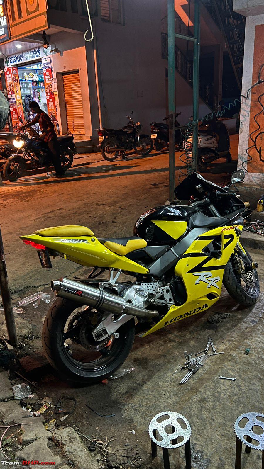

So with the phase A of parts installed and a new fuel pump to boot we took off for a long ride, plan was to do around 300 kms and come back. This would have made sure that the bike is running fine and the new clutch can also settle in. The bike started just fine and we did a nice 50-60 kms when I switched on the lights and after 10 kms or so, the bike jerked, sputtered and stopped. Damn it!!!
This was not what we were expecting, my friends caught up and we tried to push start it, it started but after 5 kms stopped again, and my odometer also died. When we tried to push start it again, it refused to start and also stopped taking any sort of self start. It was clear that this is not a mechanical issue but an electrical one. I was thinking if it is the new battery which is not holding charge and probably gave up as soon i switched on the lights, as other then that much was not changed.
I had a friend of mine on his street 675, luckily it uses the same stock battery as Blade, so we decided to swap batteries and see what happens, Voila the bike came back to life in the first crank itself. We installed the dead battery on his bike and push started it, and it started as well. We started riding again and I was thinking is it the battery, the alternator or the rectifier, or some wire has gone bad and something is shorting somewhere. After around 50 kms we stopped to see if the battery on Street has charged, and yes it had, so that meant battery is fine, and we decided to start back home before the battery on blade died again. The whole thought process of buying a japanese bike which are bullet proof when it comes to relaibility was a big question mark in front of me right now.
We reached home swapped batteries and Blade came back to life with it's original battery, atleast I was sure now that this is what needs to be fixed. I was doubting the stator or rectifier, but changing stator would have meant another circus of getting the stator and also a new gasket to stop engine oil from leaking. The rectifier and the wire around it was also getting very hot, and when we were checking the battery power using voltmeter we were hardly able to go over 12.8V. Spoke to yassar from motospark and he advised that since you are too far, you just take out the rectifier and send to me, I will test it and let you know. Sounded fair, and that is when we started to dismantle the rectfier.

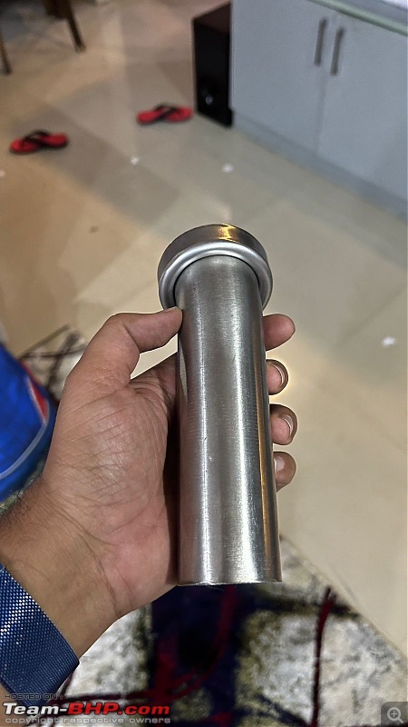

I ordered it with Baffle and once you put in the baffle it sounds just like stock, it is when you take the baffle out that it comes in it's own and sounds absolutely brilliant and makes you realise that yes it is indeed an Inline 4 bike that you are riding.
Pic with the Exhaust Installed.
A college dream fulfilled – Mark 13 – The Honda FireBlade 954RR-whatsapp-image-20221010-8.09.29-pm.jpeg
The size of the baffle.

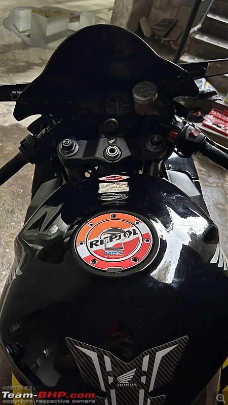

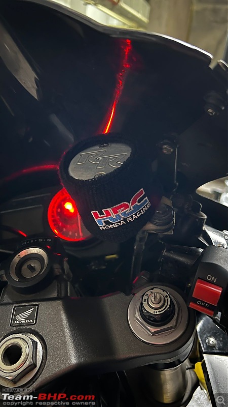

Last was to add some stickers and the reservoir sleeve, some more stickers need to be procured.
