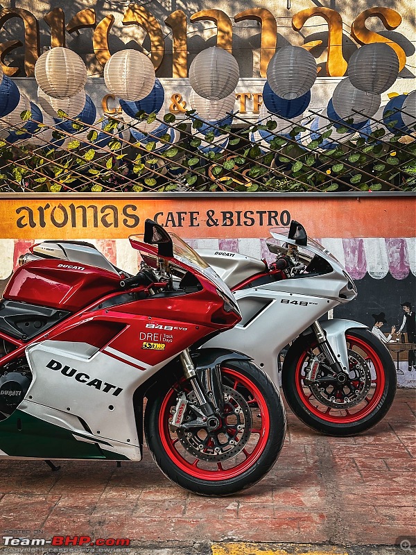

1k kms is finally done and dusted.
Did a small ride to Bandra and back as I had to drop the bike back to have the oil seal issue sorted and have the clutch slave fitted along with the Tappezzeria seat covers fitted.
Also, met up with another 848 EVO owner over breakfast for the first time and had some good conversations around bikes and our respective rides.
Some pictures:

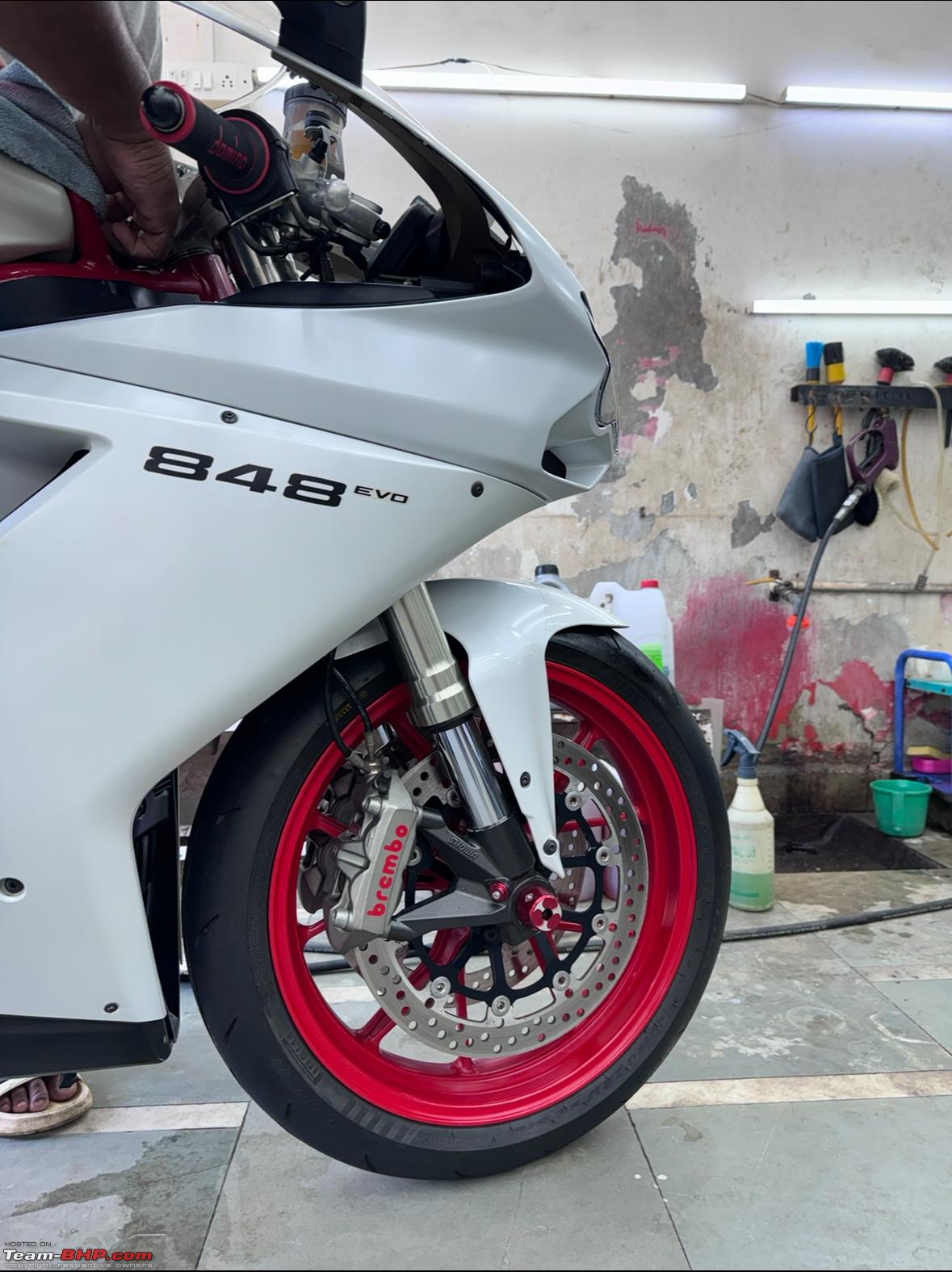

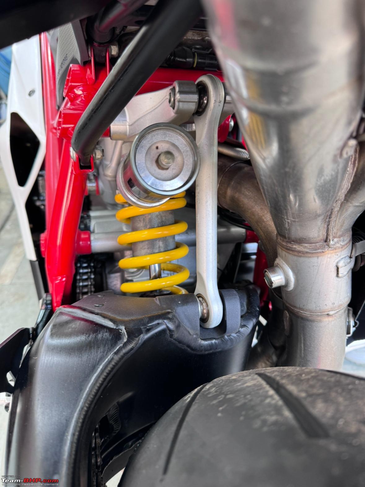

Bianca is back home and finally all the issues have been resolved main ones being the left fork oil seal leaking after multiple replacements and the CNC clutch slave fitment.
For the fork issue the whole left fork was dismantled and hand buffed on the lathe machine as it had developed pitting with years of standing still. This method was a trial and a last resort as then the only issue would be to replace it with a new inner tube. The method seemed to have worked as I haven’t seen oil leak yet. Also, the front suspension oil was replaced for both legs and tuning was changed with reduced preload on the front which now helps absorb the road undulations better. The rear shock too was opened and cleaned thoroughly to remove the rust spots which had developed during storage and was greased up. Also, the rebound on the rear suspension was increased.
Further the rear and front tyres were taken out to clean and grease the wheel bearings and the brake callipers both front and back were opened and cleaned along with the brake oil change. The CNC clutch slave was fitted using a single 1mm shim and the oil was bled and replaced completely. Since, major working components were opened and cleaned the T cone set was opened and cleaned as well and new grease was applied.
Another change done was replacing the battery as the current exide battery base rating was not correct and it was replaced with a 9 Ah batery. Now, the cold start is faster and stronger and the grunt from the engine is also stronger with extra noticeable heat from the engine.
And finally the seat covers were fitted as well and now the list of parts that I had ordered have all been fitted on the bike. The steering damper can be repaired but will need to order the oil seals but since I have already ordered an aftermarket replacement will use the OE one as it is now. Also, have ordered the radiator guatd from CNC and front fork protectors from DUCABIKE.
Now, hopefully I can now enjoy the 140 hp without any new drama from Bianca
Some pictures…

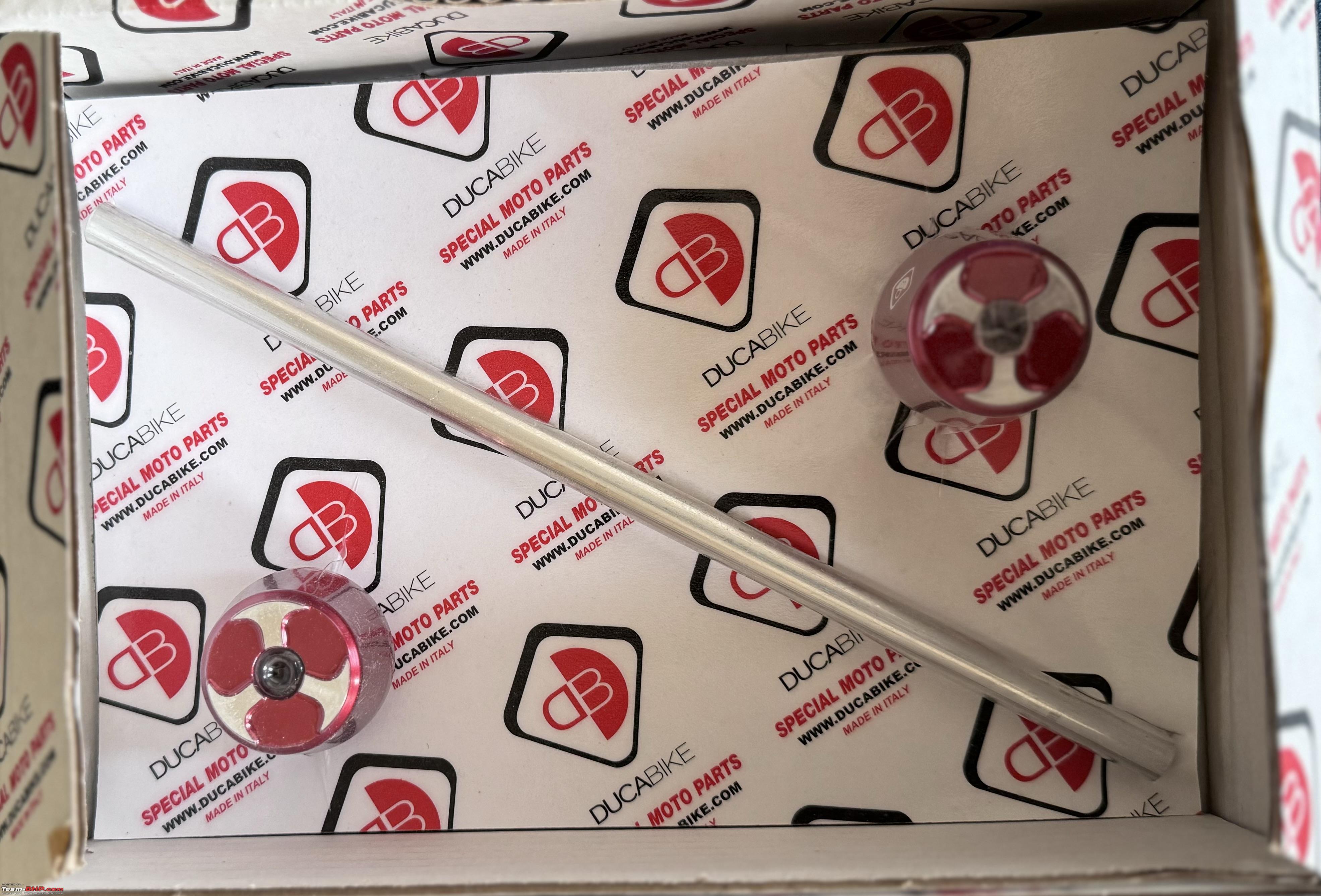

Bianca has been adding kms and running flawlessly but all within city limits and would like to take her for a longer spin on the highway but with lot of travels and other family commitments it has been difficult in the last two months.
The following parts/accessories have now arrived and will be going on the bike once I am back from yet another trip and hopefully in early March.
a) DUCABIKE front axle protectors
b) CNC radiator guard
d) Matris SDR steering damper
All the above parts were sourced through my good friends at Lanesplit and after getting a feel of the quality and precision of the rear sets on one of their bikes that maybe next on my wish list.
For now though the above parts and Samco hoses will be going on Bianca next..
Also, on a recent trip to Singapore picked up a pair of riding boots from Dainese and looking forward to try these as well.

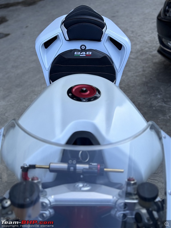

Brought Bianca back home today after installing the last set of parts and now have to make a visit to OCD Detail Studio for its first detailing service tomorrow which has been long overdue.
Some pictures of the final set of goodies (hopefully) for Bianca:
