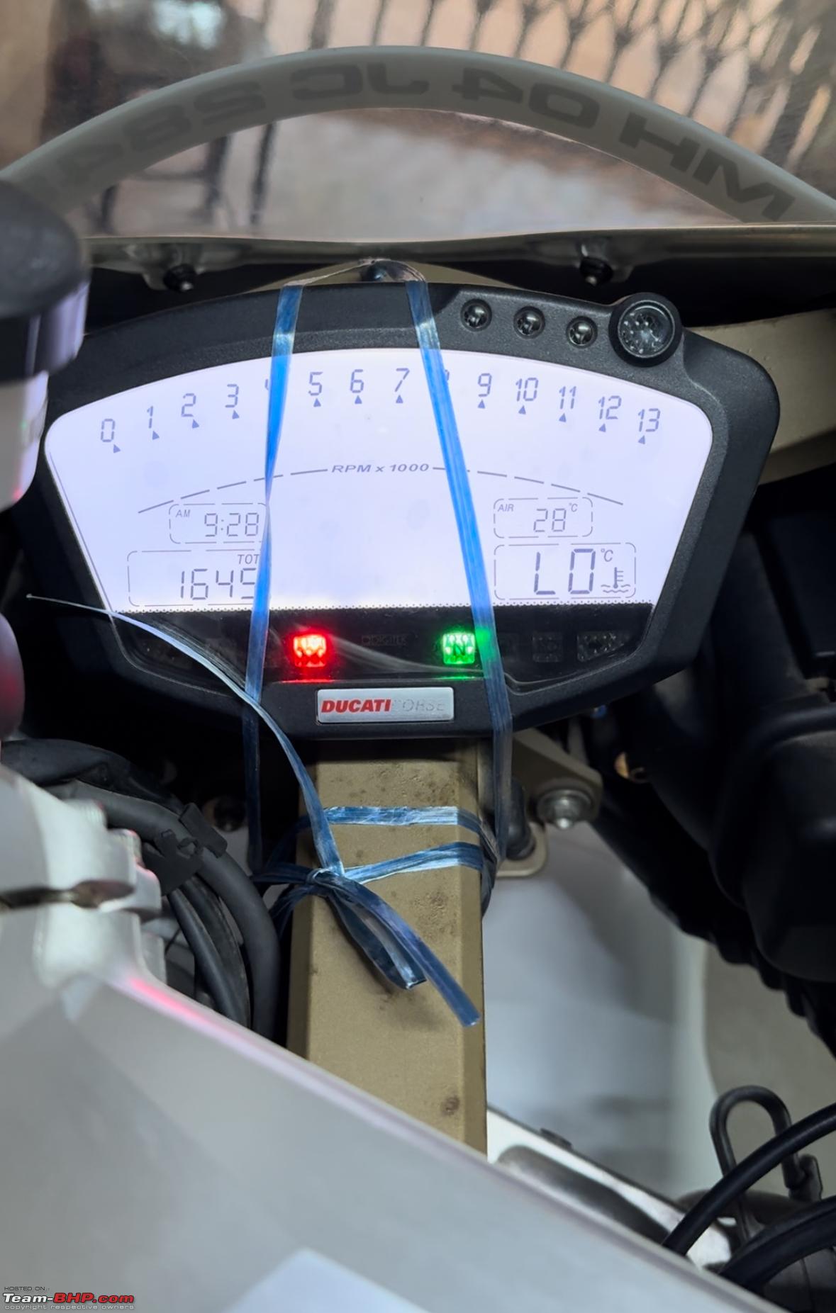

Km reading before the service. Running in is now complete. Look at the colour of the brake fluid as attracted moisture and time to change

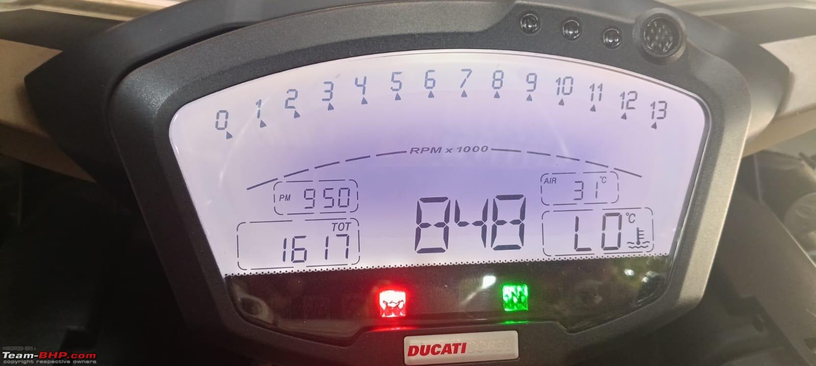

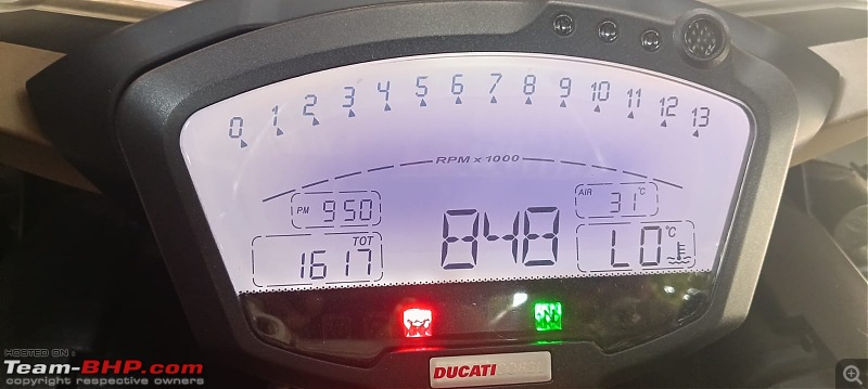

Km reading post service. Moisture issue inside the dashboard has to be addressed next.

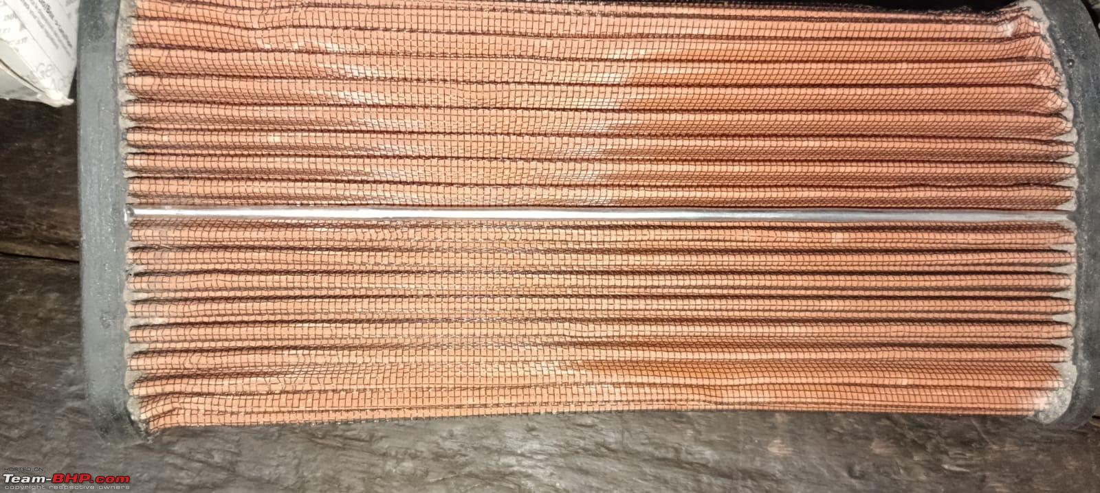

Sprint filter all clean and seems to be doing its job well
Ducati 848 EVO Corse Review | Story of Bianca-a4c4dc1209db4d7c9a65ccc9e6daa48c.jpeg

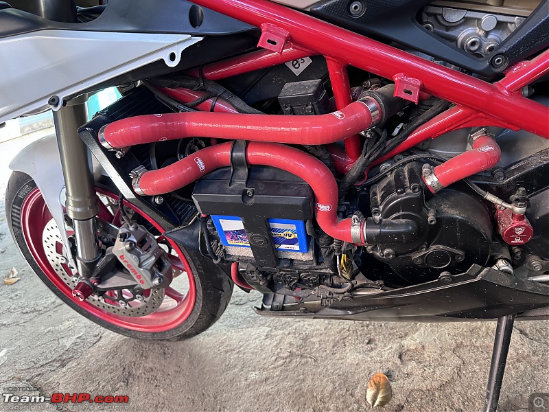

Samco hoses up close

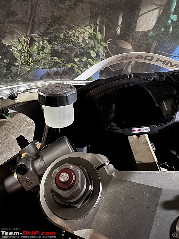

Well, not exactly sure what led to this issue but the bike had spent considerable amount of time exposed to the sun in Delhi customs and maybe that could be one of the reasons for this. For now we have replaced the whole top glass but the new issue is that we have no reading visible on the screen anymore. The bike though starts up without any issues. So, now the bike will visit another workshop where the guy who worked on the dash can check it with bike motorcycle being around and hopefully we can fix this issue now. 🤞
The blank dash. When you’re busy rebuilding rare RD’s and the Italian wants to join the party and get some attention as well..
Looks like next visit to Sumant will happen sooner than planned

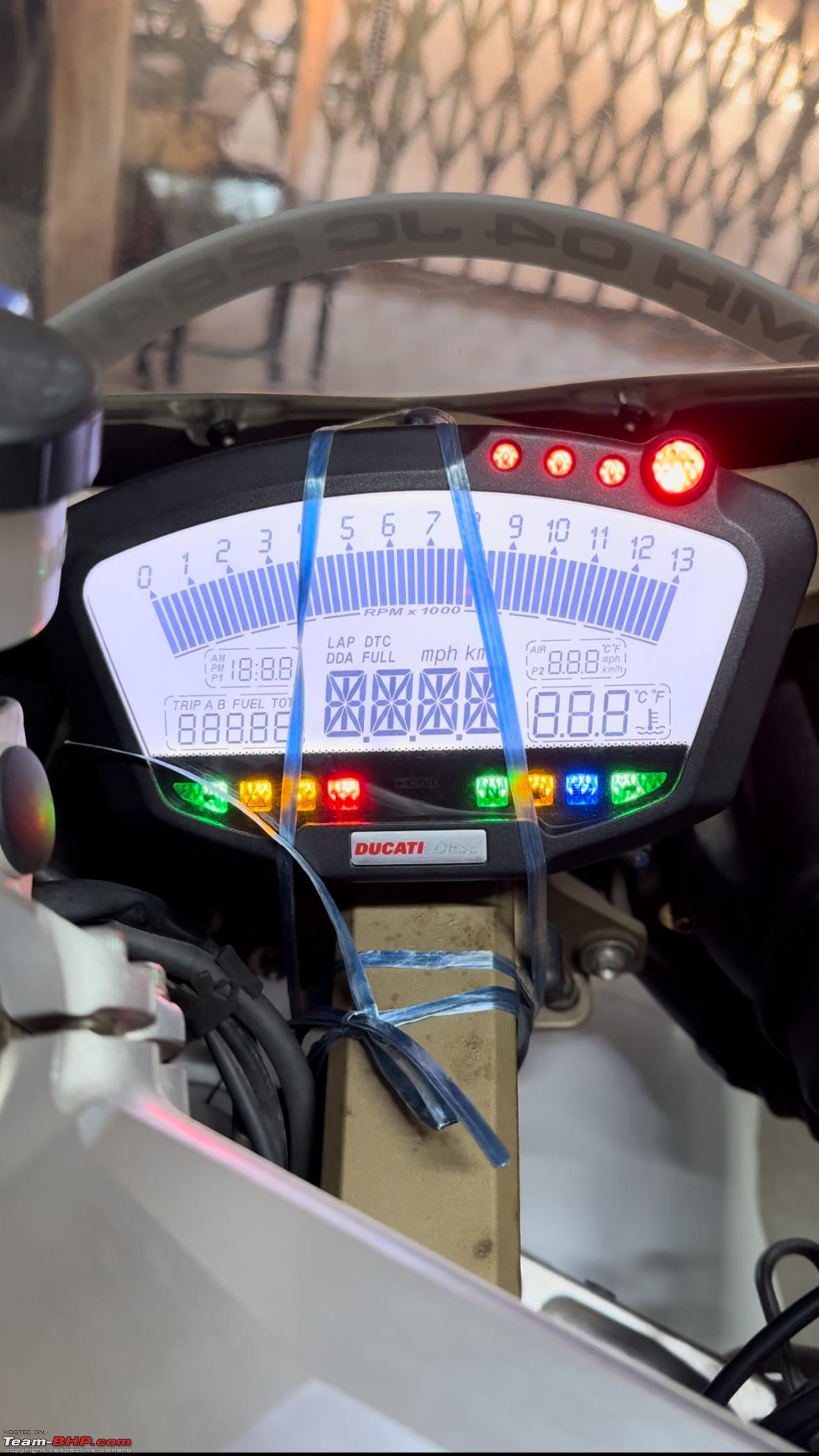

Speedometer display is readable once again
I was praying that this one doesn’t turn out to be a bigger financial damage as a new unit would have costed more than a lac and going the used part route wouldn’t be advisable as if the key cannot be programmed to the new meter for whatever reason the bike will just not start. Italian’s can be heavy on the pocket and a 12+ year old bike needs to be maintained with constant prayers .
This was not a easy fix as there are a lot of sensors below the screen and this is what made the process time consuming and when the repaired screen did not show any display it was corrected with a chip replacement and thankfully we had access to the right guys for such a technical job.

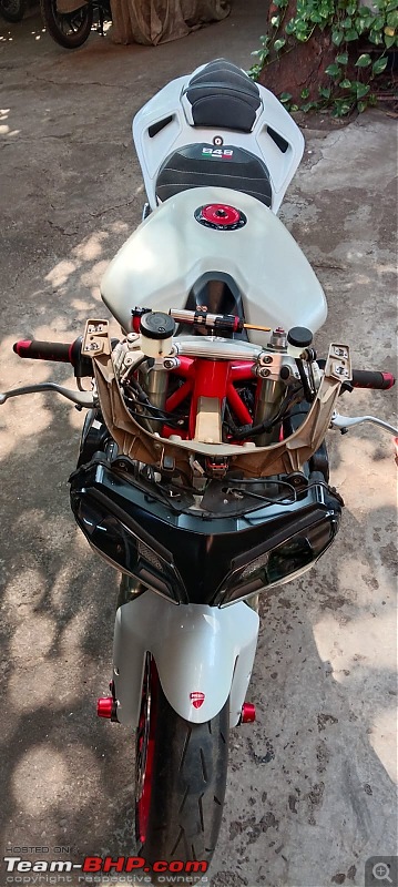

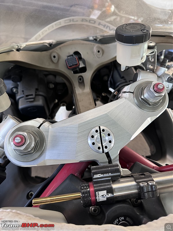

For the meter to be accessed the whole front fairing had to be taken off
Ducati 848 EVO Corse Review | Story of Bianca-577c267c292c4a269410312fa32457c8.jpeg
Looks menacing
Ducati 848 EVO Corse Review | Story of Bianca-91b0211e38fe4884bbf22c5417f8b81a.jpeg

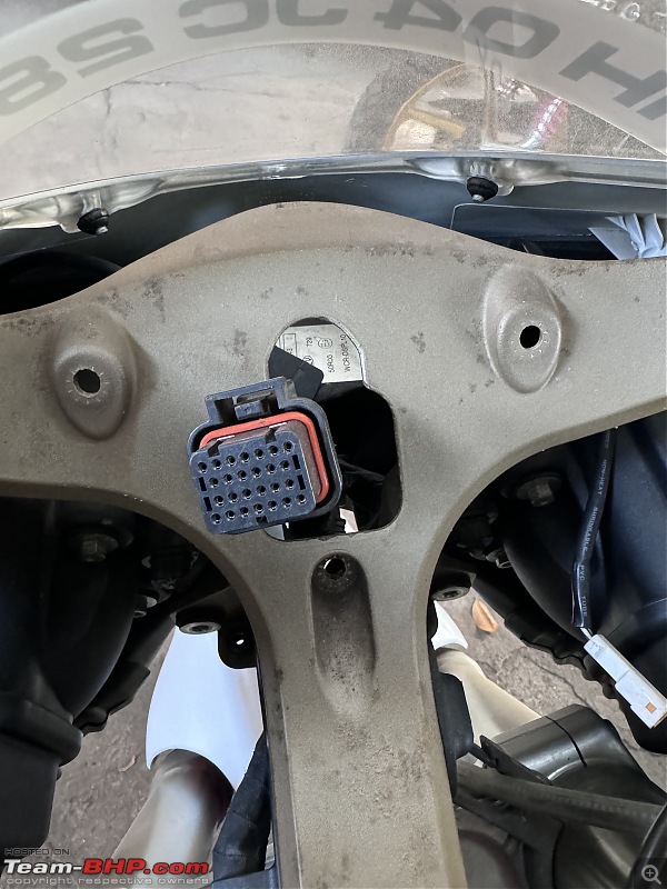

Meter mounting point
The connector which does all the heavy duty. A wiring loom change will definitely break the bank on this one

Meter returns and on the first try only the Christmas lights around the meter comes on and zero centre display. At least the bike cranked and had no errors or faults considering the number of sensors the meter itself has.

And then the D day finally arrives after weeks of waiting full set of Christmas lights comes on along with the main display
Sigh of relief!!! This one really gave me the nightmares and at a time when I have a few complex two strokes rebuild on hand already… But in the end I had to be patient and believe that we will find a solution and we did

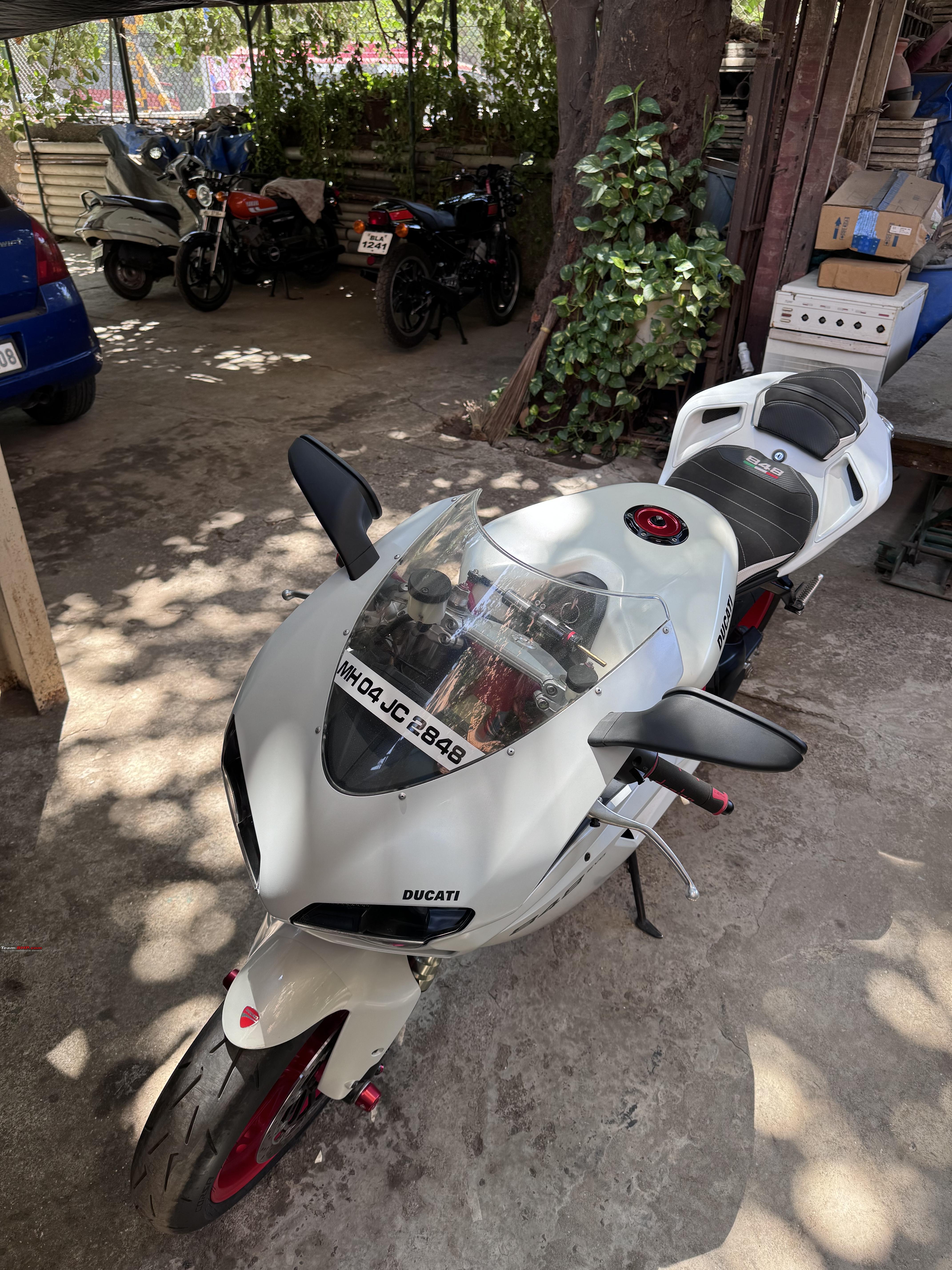

All set to ride Bianca back home. My RZ and RD 200 in the background..
