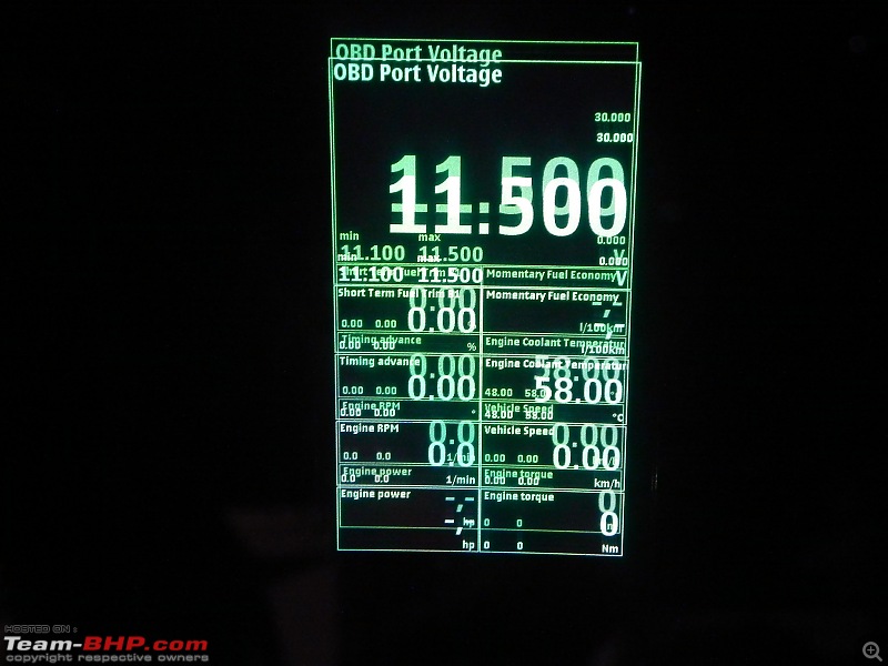

Yes, can get an OBD reader without voiding the warranty. The Figo's OBD port is somewhere beneath the steering. Its there to give us info, and hence will not void the warranty.
You can get cheap OBD readers tru ebay. They throw a hell lot of info, like Intake Air Temperature, Coolant temperature, throttle position, instantaneous fuel consumption, voltage across the terminals, pressure, speed, rpm and what not..
Here's a snap of heads up display on the windshield. You will need a symbian/android (preferably android) to read the values.
