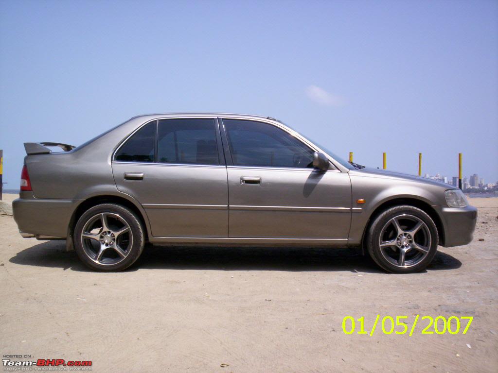

I'd say about 20 - 25K for a really good job. Here's a picture of my OHC when I got her painted the same way that you are proposing:
