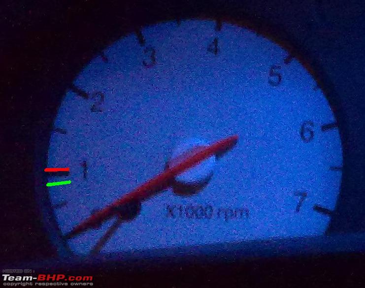

Guys, im having a weird problem with my scorpio's(non-crde) idle rpm. What happened is, few days ago, i gave the scorp for an oil service(asked them to change all oils and filters) and upon receiving the vehicle after the service, i noticed that idle rpm was higher than it used to be for so many years.
The high rpm affected the drivability a lot. The vehicle started to guzzle a lot of diesel, couldnt drive slowly with higher gear(previously it can run at 30 to 40kmph in the 3rd gear, but after the hihg rpm issue, i had to shift down to 2nd and 1st very often in city driving). So i sent the scorp back to the garage to correct the rpm issue.
I dont know what they did, but this time they reduced the rpm too low and starting problem creeped in(it is much worse during cold start). And the most annoying problem that exists now is whenever i press the clutch(after the engine heats up) while starting off from traffic signals are when i keep the clutch pressed for 5 to 10 seconds in bumper to bumper traffic, the falls below 500 and the vehicle tends to shut off.:Frustrati
i took the scorp to a local garage, the checked the diesel pump and tweaked the rpm settings but no use.
Now, what do you guys think the problem might be?
Green mark shows the point at which the idle rpm used to stay before the service and red mark shows the higher rpm level after the service.

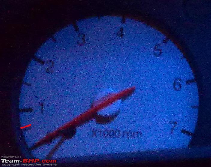

Here, the red mark shows the rpm after cold start(it raises very LITTLE after the engine heats up)

hi badboyscad, has your rpm problem solved?
