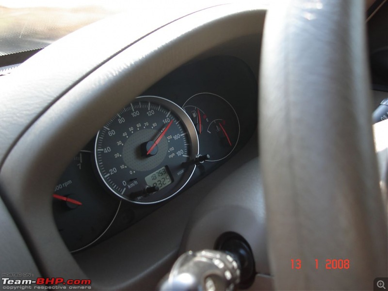

Originally Posted by badboyscad View Post
For the past one month, i feel that my scorpio's engine is overheating and i dont know the reason. So please share your knowledge about this and let me know what could have went wrong. im attaching a picture of the heat gauge.
Attachment 21050
The needle goes upto the red mark that i've made, is this normal?
even i noticed the same prob recently. here is the pic.but mine is a crde engine
Mahindra Scorpio : Issues & Solutions-dsc02546.jpg
