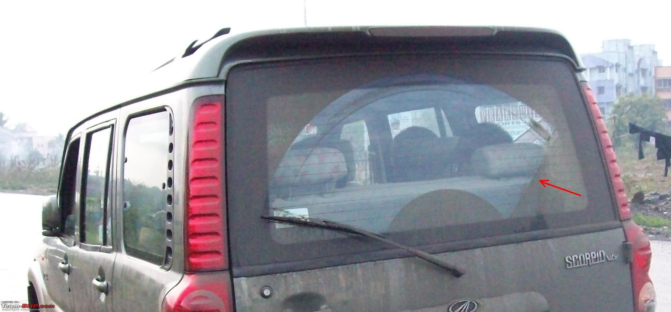

Hi, Some minor issues cropping up in the recent times:
The car has done about 8000 Kms in 1 yrs 2 months.
1. The front part of the suspension is squeaking & creaking rather loudly when I go over a pot hole or a speedbreaker.
I had this issue originally when the *** replaced the front bushes, any suggestions whether I should go back to them again with the same problem?
2. Lot of rattling and viberations are there mostly from the drivers side door and rear seats, the rear seat issue have been located to a missing nut in the second row base, (the nut has come loose on its own and is now missing) and the base is now rattling. The cause of driver side door viberation is not tracable, i checked the nuts, they are all tight and in place.
3. The driver side window makes a creaking sound when it reaches the top, as if the motor is trying to force the glass up even touugh it has reached the full distance.
4. The rear wiper makes a "thuk" "thuk" noise while in motion and if you see the pic it does not go down completely on the right hand side.
5. The volume control reduction button on the steering wheel has come loose and it would not set back whatever I tried, so have tired to fix it in place with a piece of cello tape.
This seems to be hard rubber and you need replacement , I think wiper life is about 1 - 2 year max.
The squeak from suspension is a greasing issue. Get the Jumping rod/anti roll bar bushes checked.
As for the wiper, replace it, normally indian vehicles use syndicate wipers, and its a miracle if they last 2 years

@m_upreti - Wiper travel seems fine, nothing to worry about. About the noise, like the opther have said, either the rubber has become hard or the milling on the shaft holding the blade has worn off.

Thanks tsk,
I plan to visit the *** this weekend to get the suspension issue looked into, the sound is getting on my nerves.
As for the wiper I may need a replacement.
