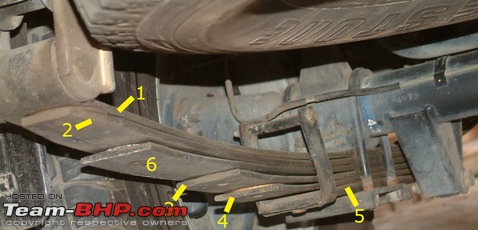

I like the word bobbing. Yes, it is very much in the older scorpios with the leaf springs. To be honest the newer ones too have it.
My FNG suggested something to me that made a lot of sense. Ever since the bobbing and the side-by-side roll has considerably reduced, plus the ride feels better.
Originally, the leaf spring set of the Scorpio consists of 5 leaves. While the support gap between 1 & 2, 3 & 4 and 4 & 5 leaves is ok and load bearing, the distance between the 2 & 3 leaves is more, thus exerting extra strain on leaf No. 2. And mostly it is the leaf #:2 that snaps.
FNG suggested me to add one more leaf between 2 & 3 to increase support. I did that and after that undertook a 3000 Km trip to Leh & back. My scorp held steady on hairpin bends, jumped over boulders without bobbing and the rear seat passengers didn't bang their head on the roof. The attached picture will explain this better.
Leaf #:6 is the added leaf:
Mahindra Scorpio : Issues & Solutions-leafsprings.jpg

Thanks gd1418, your photo made things so clear. Adding a leaf to stiffen my rear suspension seems to be a good first step option, considering that the composite leaf spring pair being offered to me has a price tag of 20k.
If fellow BHPians can suggest a good FNG for leaf spring work close to Koramangala or Marathahalli (Bangalore), it would help a ton. Cheers, Mohit

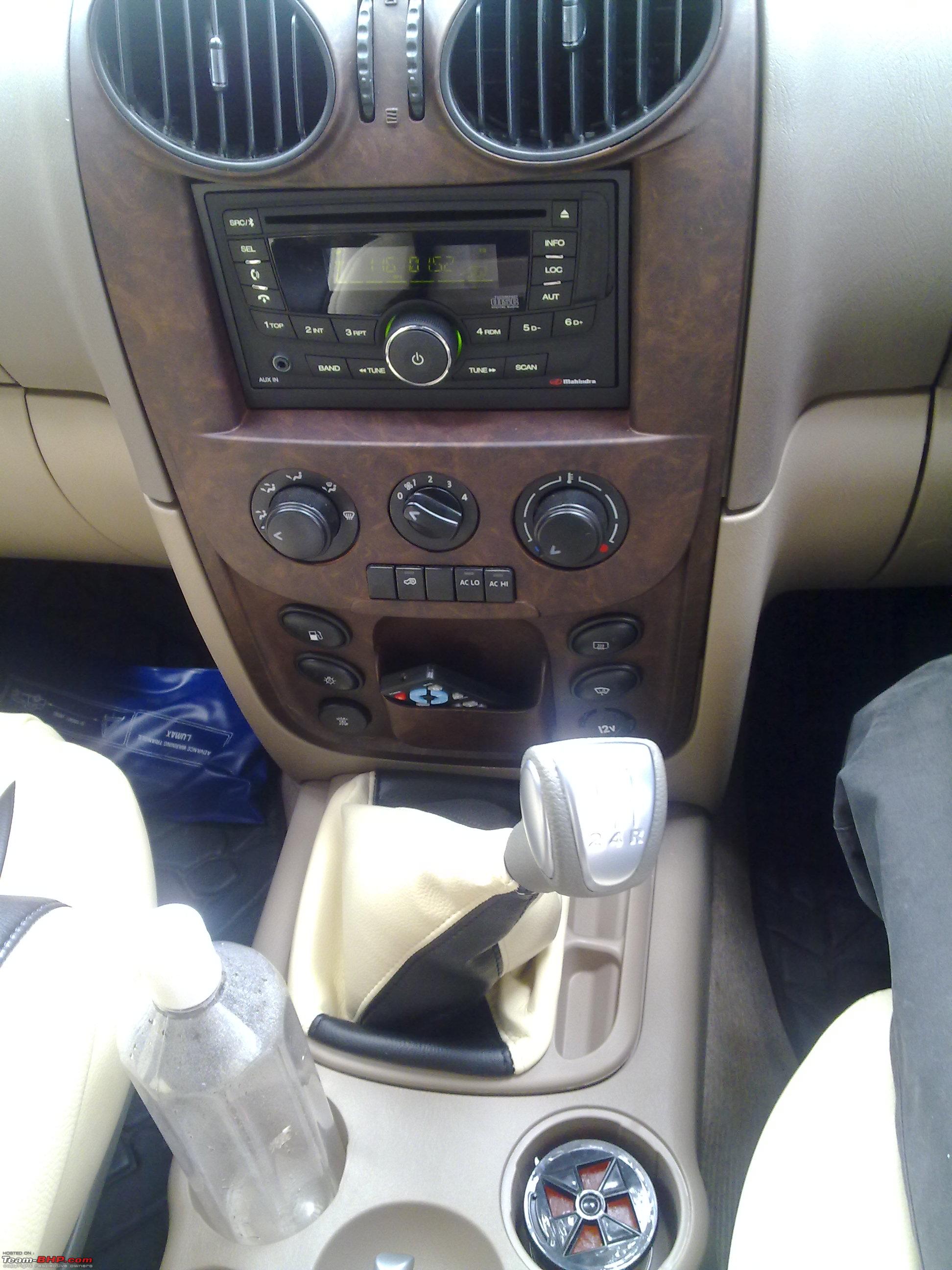

Originally Posted by WanderNomad View Post
All of those who wish to add an additional switch for fog lights without a hole in the dash, there is a switch available which fits into the blanks next to Fuel lid switch / rear defogger switch. Its a simple process, just take out the blank and add this switch.
Hey Nomad, can you post a picture please? Are you talking about the switches in the AC console? Or is this applicable only to the entry level Scorp?
Here is a picture of my console.Mahindra Scorpio : Issues & Solutions-16012010068.jpg

@wandernomad & @tried:
This switch is no longer a blank for the VLX version. It is the switch to turn off the Micro hybrid. Right now there are no blanks are the AC switch is a single piece. Looks like drilling is the way to go.

@condor: Before this was undertaken, I was told that the ride would become stiffer but on full load the ride would be smoother. But immediately after this job, I left for Leh with full load - 4 passengers, and boot full to the brim.
None in the car complained about stiffened back, neck or ride after the trip. I've sort of got used to the ride when I ride alone in the car.
@GD, didnt the ride become stiffer with the added leaf ?
You are fully right.
Here is a picture of my console.Attachment 266834
A very rough and quick attempt. I have marked the blank (I am not good at editing pics)

gd1418 : I've sort of got used to the ride when I ride alone in the car.
@GD : You were told that on full load, the ride would be smoother. 4 people + luggage is quite close to full load, and the Scorp has behaved as predicted.
Leaf springs will behave better on more load. The question is - how is the ride on lighter load ? Not about getting used to, but about more bounciness / more stiff / .. ?
