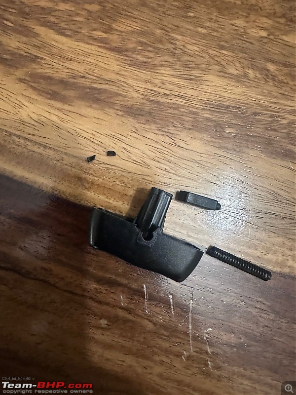

The W/N button on my 2016 Scorpio Automatic gear shifter has been broken by the guys at detailing studio I used.
While they will have to cover the cost of this repair, anyone has any idea where in the world I can get this button from?
Mahindra says it doesn't come as a separate part and the whole gear shifter assembly will have to be replaced
Here is a pic of the button, it is completely broken:
Mahindra Scorpio : Issues & Solutions-scr20241028nxgm.jpeg
Mahindra Scorpio : Issues & Solutions-whatsapp-image-20241028-14.12.31.jpeg
If anyone has any ideas on how to fix this please help! I am at a total loss and supposed to be going outstation in a few days time on a long road trip. HELP PLEASE!
