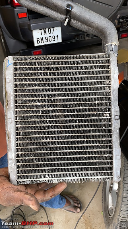

my Scorpio has had, over the past month or so, very low cooling on the two left AC vents and normal cooling on the vents to the right.
the AC gas had dropped by some 280 grams.
The tech suspects it is a compressor issue
The only part on the compressor that can cause a refrigerant leak is the shaft seal, but I doubt that would have packed up this early.
Yes, I've seen two cars with failed seals after prolonged non-use in the lockdown. These seal leaks had resulted in the refrigerant low side pressure dropping to approx. 20 psig.
The seal leak , unfortunately in most cases, cannot be detected with the vehicle standstill.
I feel this episode is a repeat of your earlier Scorpio, where the evaporator core was the culprit.
A leak test would rule out the accessible parts viz. Condenser, hoses, joints.
Good luck !!! Are you going to Prakash again?
Exactly. The car is with Prakash and the Evaporator Core is the culprit as usual :(. What's up with failing exactly at the 5 year mark I am not sure.
Here's a photo, and yes that's a Hummer in front, waiting for some AC work.
Mahindra Scorpio : Issues & Solutions-ad6b435c48a34b60a5037c18f6d2206a.jpeg
hserus is offline   (2) Thanks

^^ It's become a norm of sorts in India to see Indian/German/Korean cars' evaporators fail in 4-5 years.
Your old evaporator core is featured here (A/C mechanic - S.Jagannathan Auto Air conditioner (T Nagar, Chennai))
I see that last time, the leaky point showed a visible refrigerant oil leak while this time, it looks dry.
Just last week, a 2015 Hyundai i10 Asta in Ahmedabad with just 37k on the odo had a leaky evaporator which was changed. Parts and labour totalled 8k.
I do not know what is the type of coolant shell is selling or what dilution they are using, from their website the OAT pre mixed coolant meets JIS specifications needed for the engine however the manual asks for 30% dilution and shell premixed coolant does not say what is the dilution! We know from the manual that Mahindra`s coolant is good for 3 years or 80,000 Kms - small price to pay once in 3 years.
Is there any corrosion on the evaporator?

I see that last time, the leaky point showed a visible refrigerant oil leak while this time, it looks dry..
The new evaporator for the Scorpio itself cost almost 6500. Larger and heavier than a typical hatch or sedan one though.
There were several smaller leaks the guy pointed out to me. Not easily visible as the area I took the photo in was his rather dimly lit shop.
I could have pulled along with this coil for another three or four months till the stains grew larger and more visible I suppose and the cooling inside the cabin went to nonexistent

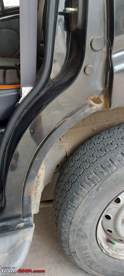

On the left rear, I see that the rust has started to come out and the door frame has started to rust. The hole in the door is scary.
Mahindra Scorpio : Issues & Solutions-left-rear-fender-door.jpg
On the right rear, the rust has started to appear. Maybe just some treatment and repaint may be the right solution.
Mahindra Scorpio : Issues & Solutions-right-rear-fender-rust.jpg
I approached a nearby neighborhood garage to evaluate the cost of fixing this. All the rust cleanup, fixing, bumper painting along with the front grille along with an underbody rust protection coat is coming to around INR 70k
Assuming that the resale value of BSIV vehicle will depreciate over time, I am thinking if it would be prudent to keep it running for life (2025) and then sell for whatever value it brings.
The resale value as of today would be less than INR 3L considering the rust. However my thought process is around the usage of the new car as I expect very limited usage, given the current circumstances.

I have the same issues with severe rust and the only thing different is that my Scorpio has done 245,000km since 2011. here is my logic
1. avoid selling the car if its mechanically ok.
2. delay the rust fix till next monsoon.
I am basing my logic on the uncertainity of economics and the avoidance of capital costgs and EMI. Should these not apply or be of concern to you, you may make appropriate decisions.
Delay of the purchase will allow more dust to settle from smaller cars like Sonets to arrival of new 2021 Scorpios and will have you in better financial stead in September 2021 to buy a car with a larger down payment and smaller EMI.
Your car may look like hell, but better the car look sad than your accounts.

I am in the same thought as well. Mechanically (touchwood) the car is in top condition. Regularly maintained and serviced the engine is smooth and performs well.
I am not bothered by how it looks now, I know it rides well and that's all I want . I have already pushed one monsoon already, will try and delay it as much as possible, before I visit the mechanic to fix things. I am checking out at multiple places to understand the cost differences.
With multiple new launches happening this year with the new generations of Scorpio, XUV and other BS6 versions like Hexa, I am keen to wait to check and pick the right vehicle as it would live with me for another 15 years for sure.
