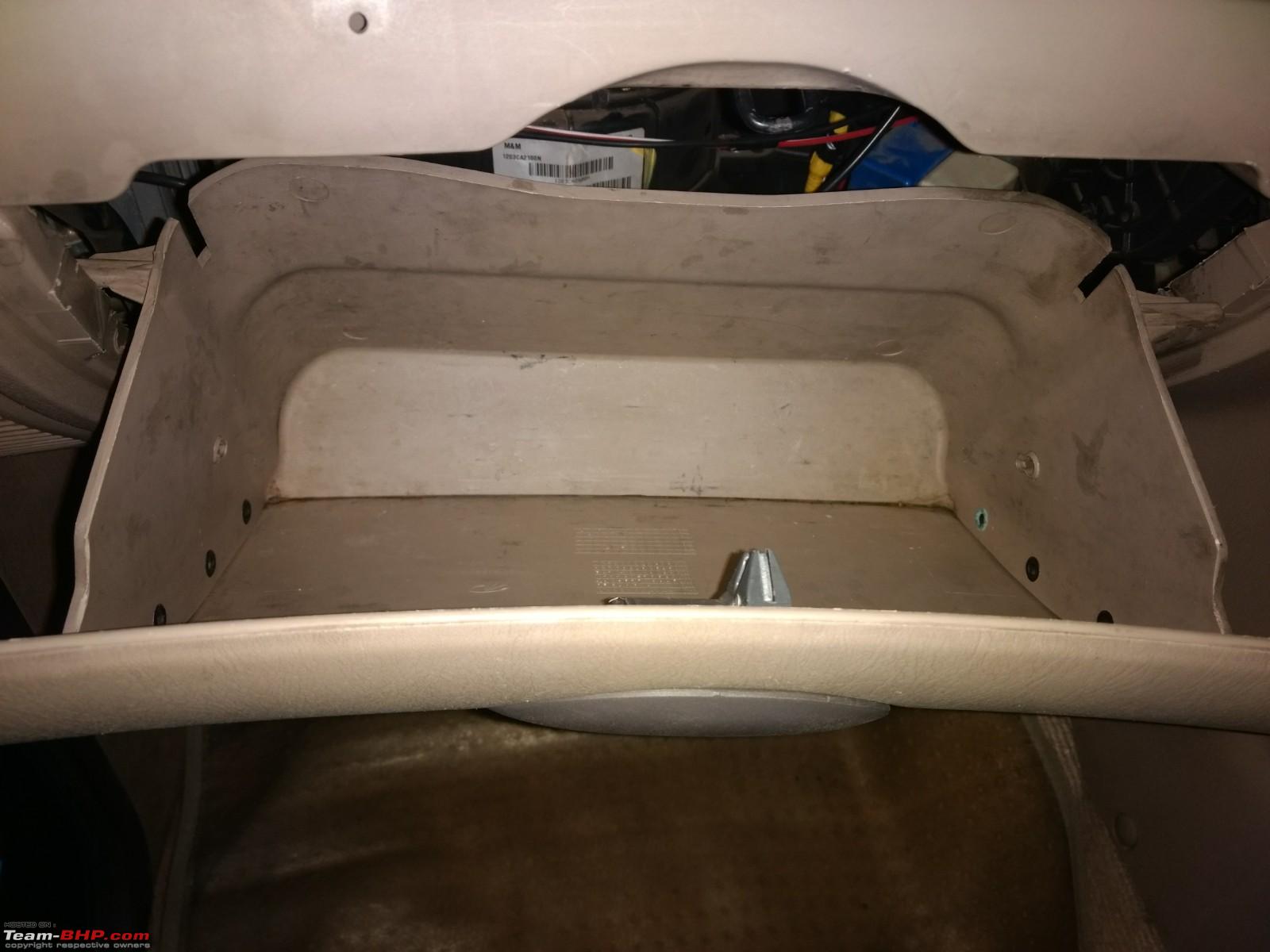

Old 10th March 2018, 00:32   #4383
Posts: 15
Thanked: 5 Times
Re: Mahindra Scorpio : Issues & Solutions
The glovebox lid should be available as a separate part easily. Else, the best remedy is to look for both the parts in the scrap market and use them. It will work out cheaper.
BTW, can you post pictures of your glove box lid?
Hello Devdath,
Thanks for the reply.
here are the images of both Rail and Glove box.
Please suggest a scarp market location in Bangalore. I will go and explore if glove box and the rail cap are replaceable.
Raghs
Mahindra Scorpio : Issues & Solutions-img_20180302_182516091.jpg
Mahindra Scorpio : Issues & Solutions-img_20180302_182558321.jpg
Mahindra Scorpio : Issues & Solutions-img_20180302_182505032.jpg
Mahindra Scorpio : Issues & Solutions-img_20180302_182550499.jpg
Mahindra Scorpio : Issues & Solutions-img_20180302_182344616.jpg
raghp74 is offline
Old 10th March 2018, 12:03   #4384
Posts: 4,287
Thanked: 2,816 Times
I would suggest you start by asking your service advisor if they have discarded vehicles at their bodyshop, most generally do and you can simply swap the part. Otherwise, Shivajinagar is the best place for such items in Bangalore.
n.devdath is offline   (1) Thanks
Old 16th March 2018, 13:40   #4385
Posts: 15
Thanked: 5 Times
Thanks to Mr. Veeresh (SA) from Chrome Motors (Mysore Road). He looked at the same images I shared here and told me all he needs is 5 minute to fix it. Then I took my vehicle there yday he fixed it as he committed. The issue was with detached linkage at the back side. He simply re aligned it.
I got also the new rail caps from them.
raghp74 is offline

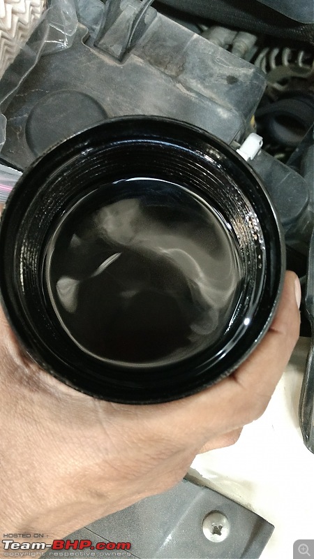

Old 16th March 2018, 23:55   #4386
Join Date: Feb 2007
Posts: 46
Thanked: 24 Times
Hi Team,
I have Scorpio S10 non-4x4 Nov 2015 model.
The car use to flash engine light and after some time stalls.
As a suggestion from local mechanic I use to push the Diesel filter assembly push button 10-15 times and it starts again without any issue just that the RPM meter fluctuations happens for some mins and then things are smooth.
I tried to accelerate till 4K rpm in 3rd Gear, but it's running fine.Today out of curiosity I went to Mahindra Service and they tried to open the Diesel filter assembly but one of the sensor coupler was fixed using elfee.So, they struggled to remove the Diesel filter a bit too much but able to open that.
The opened filter and diesel collected in polybag. Pics are like .
But the stalling issue is not gone and I have to go in deep to resolve it completely.

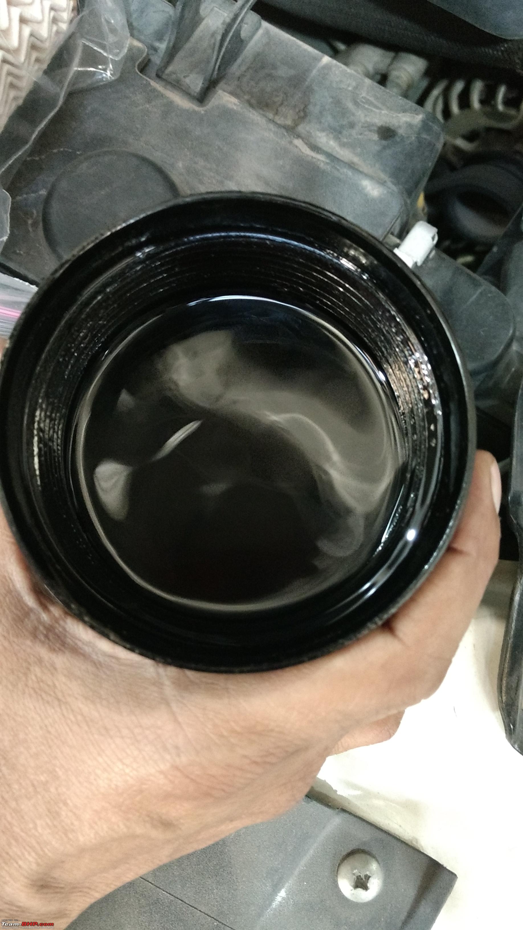

Old 19th March 2018, 00:03   #4388
Join Date: Feb 2007
Posts: 46
Thanked: 24 Times
Originally Posted by prithm View Post
Can you kindly share the pics Tyagi ?
Ok. Please see the attachments.
My driver told that he went to one of the FNG with my father and the technician over there applied fevi quick on the diesel filter sensor coupler.I was like .
At the Mahindra Authorized service centre I dint reveal that, but they guessed that someone has messed with the Diesel filter as it was tightened beyond the torque also fevi quick applied at the sensor coupler.I asked if the coupler can be fabricated again, they told that it can't be and the whole wiring set will need to be changed.
Today, I have got the new Diesel main line pipe, and planning to get the diesel tank cleaned thoroughly.All this is really painful.
Mahindra Scorpio : Issues & Solutions-img_20180316_174120116.jpg

Old 19th March 2018, 00:17   #4389
prithm's Avatar
Join Date: Jan 2015
Location: MAA - HYD
Posts: 669
Thanked: 713 Times
Thanks for the pics. Looks like case of heavy fuel adulteration or bad fuel station... Were there any other puncture holes near the filter housing or at the mouth of the tank...so much crud in fuel is just a disaster waiting to happen.
Feeling your pain.

Old 19th March 2018, 02:08   #4390
Join Date: Feb 2007
Posts: 46
Thanked: 24 Times
Feeling your pain.
I am feeling so much heartbroken that I haven't dare to go in-depth.May be on coming Friday I will get the things done listed below if at all these can be done in a day,which I seriously doubt.
1. Clean the Diesel tank.
2. Clean the Fuel pump.
3. Replace the main Diesel line.
4. Replace/wash the newly installed Diesel filter.
5. Use Engine flush and replace the Engine oil.
6. Skimming of Rotor disks.
7. Front and rear Break pad replacement.
8. Get the injectors cleaned/serviced.
9. Get the Front suspension bushes checked/replaced.
10. Get the air filter cleaned.
11. Get the coolant checked/replaced.
12. Interior cleaning/vacuuming.
I want to see my S10 like new and feel like going to Leh with my better half on our marriage anniversary which is just within a month..
Lalit Tyagi

Old 22nd March 2018, 22:50   #4392
Join Date: Feb 2007
Posts: 46
Thanked: 24 Times
Hi Team,
Got the Diesel tank and fuel pump cleaned today.Poured in fresh diesel from the HP Station. There was way too much
Trash in the fuel pump base and FNG technician had hard time cleaning that.Took around 3 hours to get it cleaned.
After cleaning the diesel tank and fuel pump, the S10 dint stall even once. Hoping to see smooth rides in coming weekend.Expenses incurred 600 for cleaning and 2300 for fresh diesel.
Team, please advise how to clean/filter the old diesel otherwise I wil have to discard around 45 lt of that.
Lalit Tyagi
T Y A G I is offline
