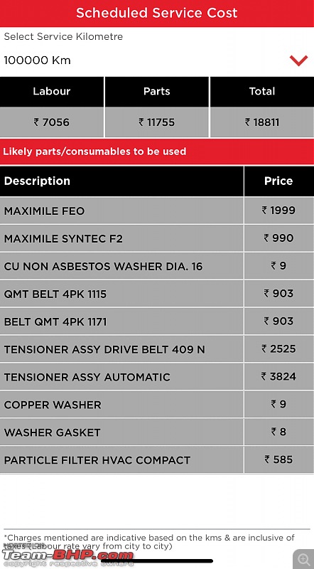

I have an 11 year old Scorpio having done 120K kms running without any issues so far. Since I want to keep it for another 3-4 years, I want to ask the experts here if timing belt needs to be changed. I called Sireesh Auto service center and they said it will cost around 15000 to get a new timing belt. My local mechanic is giving a 6000 estimate for the same. Please advise if I need to change the timing belt now (or wait till some signs appear) and where should I get it replaced from?

Every one lakh km. Get it done at a Mahindra dealer.
Thanks in advance
Any other part like water/oil pump that should be changed as well now that engine will be opened up?
Please look at your service manual for what needs to be done
Mahindra Scorpio : Issues & Solutions-1e6f5d90c649468ea145111ebdd707ba.jpeg
Thanks again Sir...engine oil was changed 2 days back. Should have done it after timing belt change. Is Particle filter same as an oil filter?
Particle Filter HVAC Compact = AC filter.
