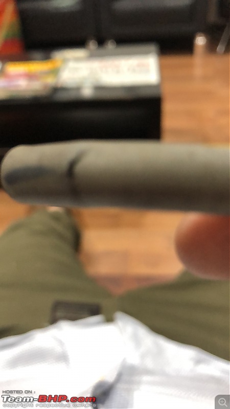

I was headed to Bangalore earlier this week when the Scorpio suddenly refused to go beyond 80 kmph and the turbo started making whistling noises. The check engine light came on as well with, as my obd2 told me, a P0299 error code.
Mahindra Scorpio : Issues & Solutions-b71b849ed90d4a9487b4f04a1a3fbf1a.jpeg
Turns out a hose had got cut, and I had this replaced at Jain Cars, a Mahindra dealer in Vellore, on a service road right off the highway.
Mahindra Scorpio : Issues & Solutions-bff61426327b4e54b086f69a1123c049.jpeg
This was diagnosed and fixed, paperwork done in under twenty minutes. Good work.
