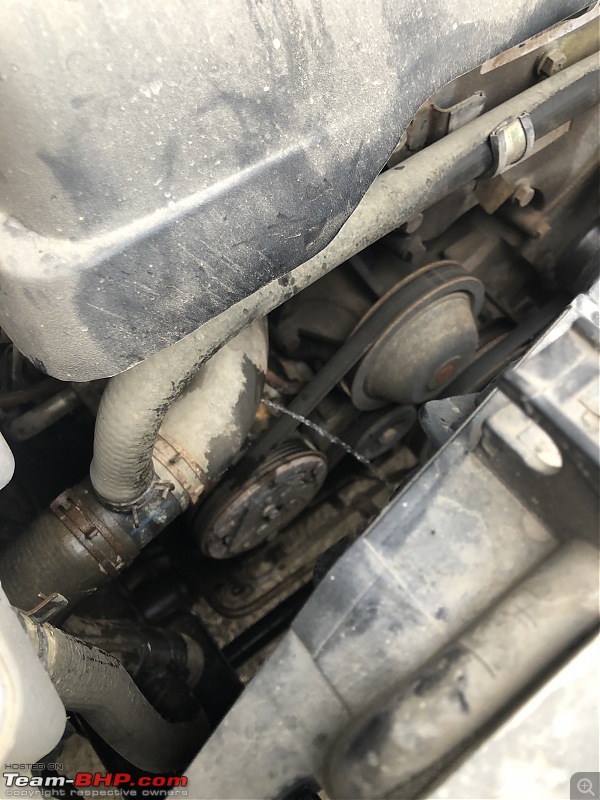

Dear Friends, I own a Mahindra Scorpio S10 model bought in 2015. So far I have completed 45000 km on this ride. We normally use it for our highway trips and primarily for going to my village in east UP.
Since end of 2020, whenever I have visited my village, while coming back to Delhi, every time I faced issues with engine heating. The problem mainly happened because of rubber parts going bad. They leaked and coolant loss happened. Showing two of the parts that gave away. I could not find the pic of one of them.
Mahindra Scorpio : Issues & Solutions-ed781606a2494aa3806a958f48503db4.jpeg
Mahindra Scorpio : Issues & Solutions-4bb8f0ac9d9e48728fd4ff8b45cb37bb.jpeg
I visited my village last time around mid July 2022 and the problem cropped up. I got it rectified in a Mahindra workshop in Lucknow.
Came back and everything was fine till August 13. That day we planned to visit Jaipur for a quick trip. But this time while leaving Delhi early morning, same problem occurred and temperature gauge started shooting up. I decided to cancel the trip. Family was massively upset. I was also feeling bad as this happened again and this time the occurrence between the two consecutive events was just a month.
I do observe that carpeting under the drivers foot area is wet and it is not water. Because it seems to be a bit sticky. I read in the this thread that coolant pipes near the driver’s foot area do leak and Mahindra workshop uses thermacol for fixing this issue.
Two questions for our learned members:
  1. Whether you have observed frequent failure of coolant related rubber parts?
  2. This latest issue of wet carpet beneath driver’s foot area and low coolant, are they linked or any other hypothesis that I should consider ?
Thanks in advance for any feedback/suggestions.
I did not face any issues with hoses in my long time of Scorpio ownership. I found them to be of very good quality.
There is a heater core along with the AC evaporator in the dash. Evaporator is for cooling and heater core is for heating the cabin. The air passes through these cores to maintain the temperature as required. The source of heat for heater core is the coolant. So coolant lines run from engine bay to inside the cabin. The lines pass through the cabin to the engine bay from above the footwell area(a little left of the clutch pedal). So it is possible these lines are leaking and the wetness you see near footwell is coolant. If you can above the pedals under the dash, you may find the source too.
Even if the parts are not available readily, ASC should be able to place an order and get the parts. Did you try finding parts in boodmo? this sites comes very handy in such cases. I think(not sure) the part thats leaking in the picture is 0304DAM02510N.
