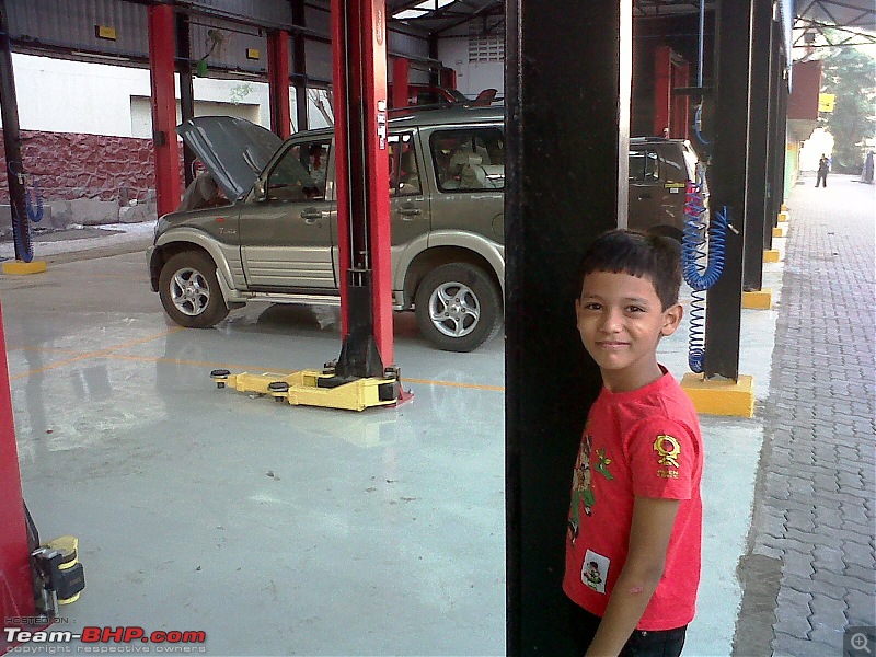

Mahindra First Choice just opened a All Car Service in Nerul & I got a call for a free checkup camp, so I took the opportunity as they are open on Sundays.
1. They did a general checkup, everything seem to up working.
2. They topped up the Coolent, Brake oil, & washer fluid complimentary.

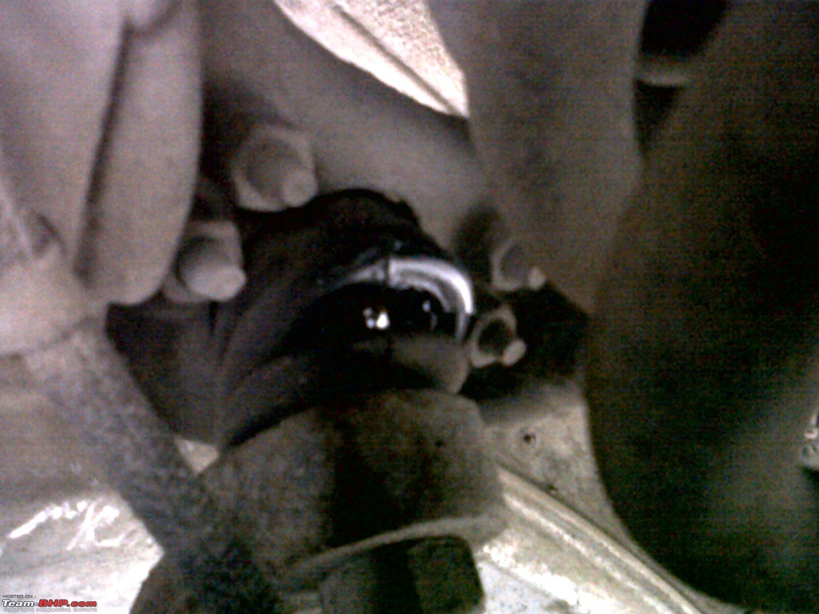

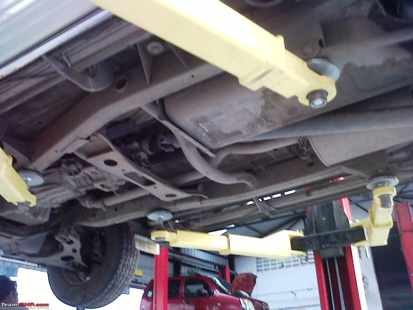

3. The car was lifted and under side checked and the following things were identified for replacement & the quote given:
a. Front Lower Ball Joint set (Rs. 850.00)
b. Front Upper Ball Joint Set (Rs. 650.00)
c. Link Rod Set (Rs. 860.00)
d. Balance Rod Bush (Rs. 100.00)
e. Labour (Rs. 1400.00)
Total Rs. 3860.00 Appx.)
Apart from this the steering retaining bolt is hitting the plastic covering on the under body which is almost shorn off on one side.
I plan to get these these replaced next week when they will get the parts along with the servicing which is due, the Paid servicing is 999.00 Rs. and includes a general checkup, wash, vaccume, tire rotation, balancing & alignment (weights cost Rs. 150.00 extra)
So I am expecting a total bill of around 4500.00
4. Top shampoo wash was done.

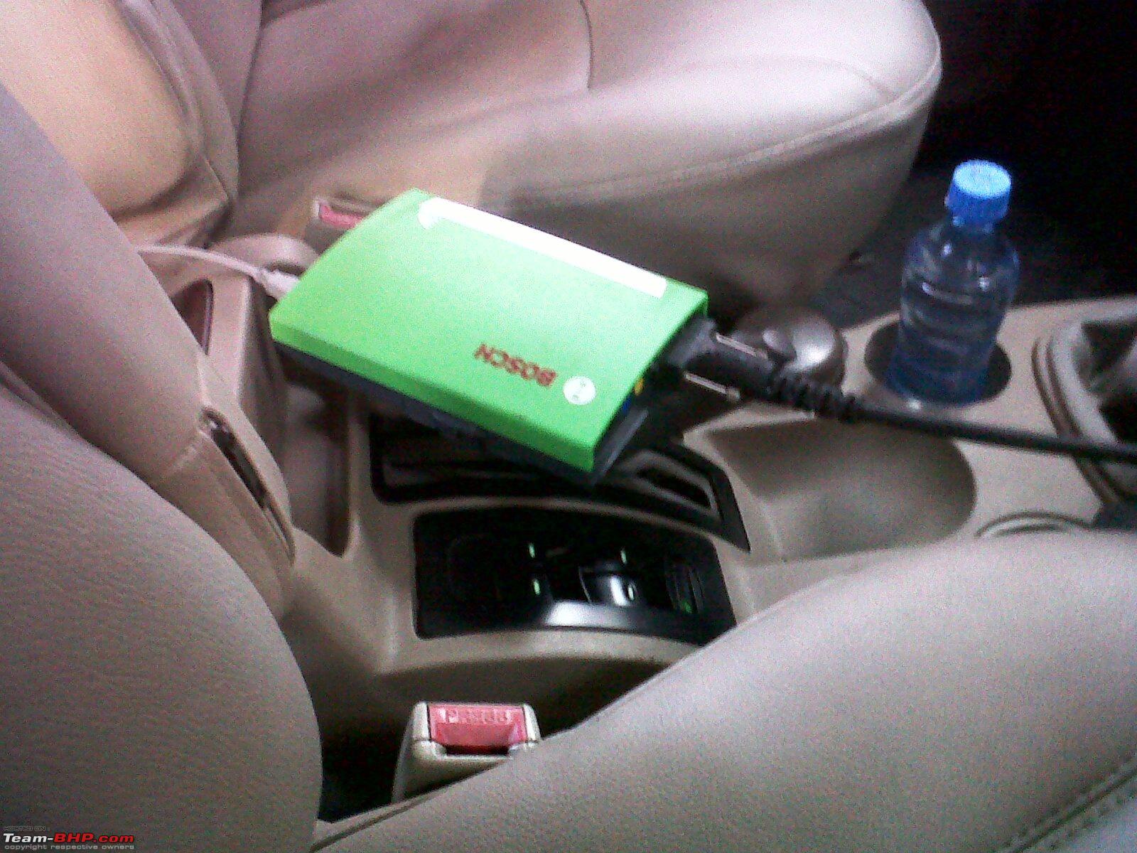

5. For the Engine Check Light Issue the scanner was attached and the following error was seen: "658 Boost Pressure Control. Regulation No Plausible" This error was deleted from the memory and now the Engine Checklight has gone off.I was charged Rs 400+Taxes (Rs. 49) for this service. The scanner incidently got inaugrated with my car and the technicians wre not too familiar with the device so my experience as an IT guy came into play and I was able to operate and diagose the issues myself and teach the technicians also.
Need help with the experts on this error as the SA was not able to explain
5. The over all experience was good, barring the time taken for washing and preparation of bills as there seemed to be a power problem, but this can be over looked as they have been operational since Dec 1st '13 only.
The SA & the technicians were helpful and prompt with the services.

My replies inline above. I got the vehicle scanned at M&M First Choice Service Center yesterday, the error showed ( "658 Boost Pressure Control. Regulation No Plausible") and was deleted from memory, now the light is gone, as per my experience if it was a minor glitch where a connection might have come loose the light would not come on again, if it does then it will have to be checked thoroughly at the M&M A.S.S.
The vehicle is driving perfectly and there seem to be no issue at the moment.

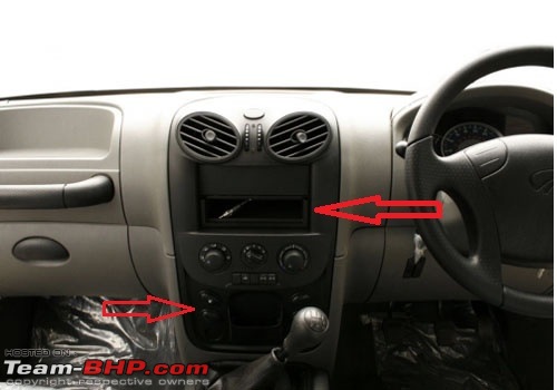

Not exactly an issue, but just want to know where can I buy the parts pointed at in the pic. I check with India Garage and Sireesh Auto, both of them dont have them.Mahindra Scorpio : Issues & Solutions-mahindrascorpiodashboard059.jpg
ANy pointers will be greatly appreciated.
Hi Rajesh, I wanted the same for a Honda Amaze as it comes with a standard double DIN slot and I didn't want to waste money on a Double DIN player, so I bought a basic pioneer with USB for about Rs.4500/- but the cheapest Double DIN avl with USB was about Rs. 13,000/- . I couldn't source this from Mahindra or any other OEM, but the accessories chap who installed my stereo was able to source it for me. He charged me 2000 Rs for it, which I felt was too high, but he claimed it was OEM and stuff like that.
Your best bet is to go to one of the high volume stereo installers in your area and they will be able to to source it. Check the price though.
Cool, thanks buddy. Will check the guys around.

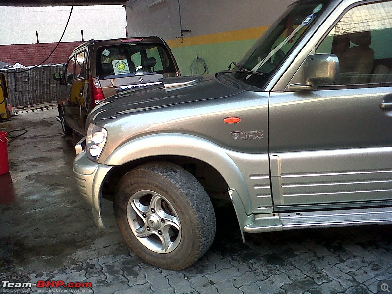

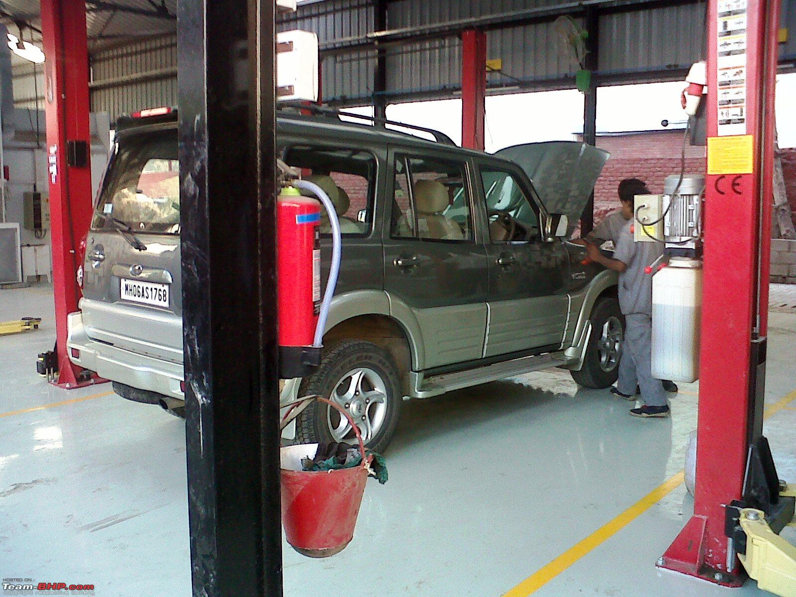

Had my 2006 Code serviced for 80k milestone for 10232/-. Hub greasing revealed a damaged pair of bearings. I am happy to say the cost of spares are reasonable thought can't say the same for labour charges for the smaller jobs.
Wasted 1500 on injector cleaners, as I am sure they really don't help but wanted the additional peace of mind by following dealer suggestions. Some work still pending due to lack of time : engine mounting (2000), suspension check and air filter assembly (2000).
While I was there at the service center, I saw one funny Scorpio. See if you can find the funny part.
Is it that snorkel like thing on the bonnet?
Count the number of DLR
