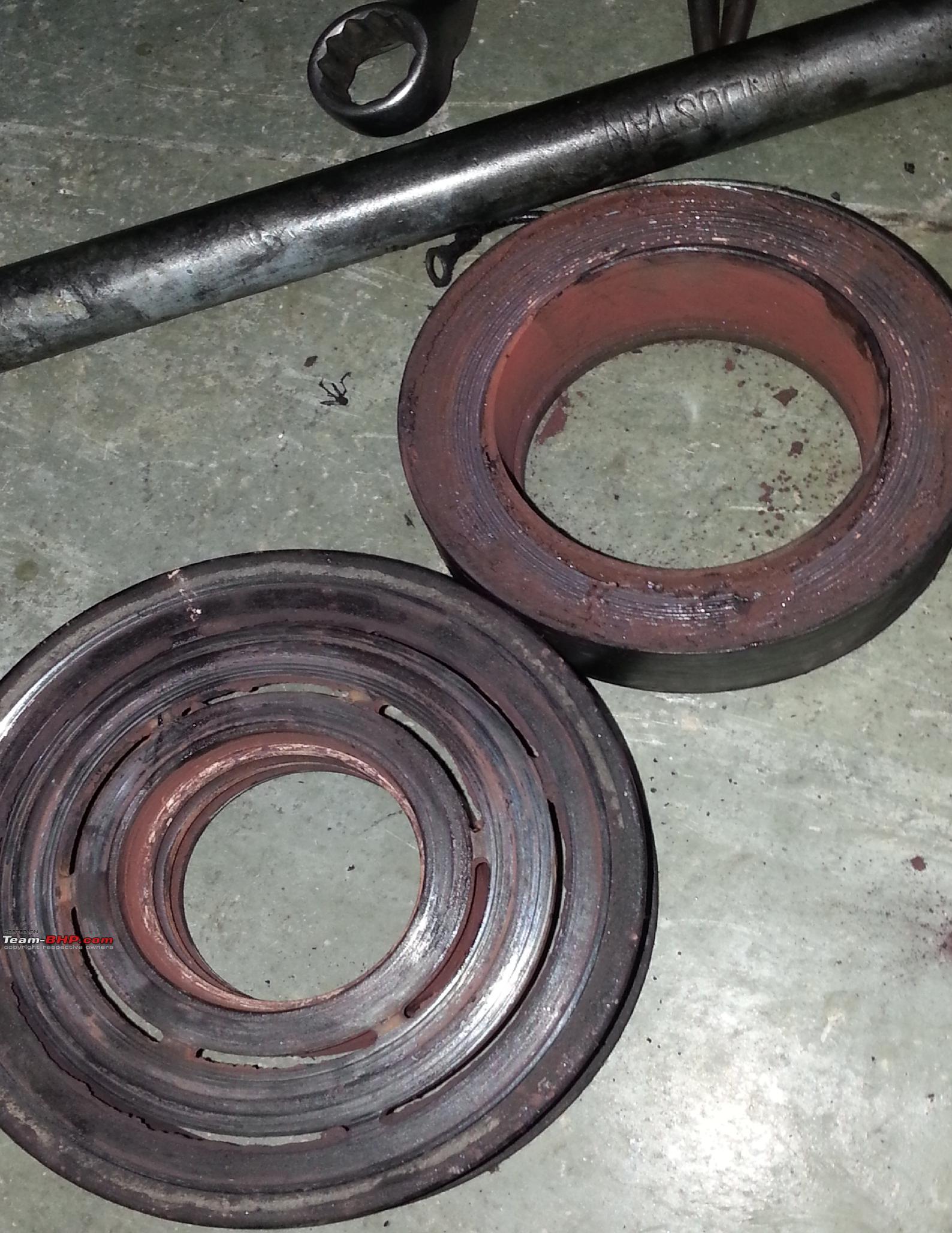

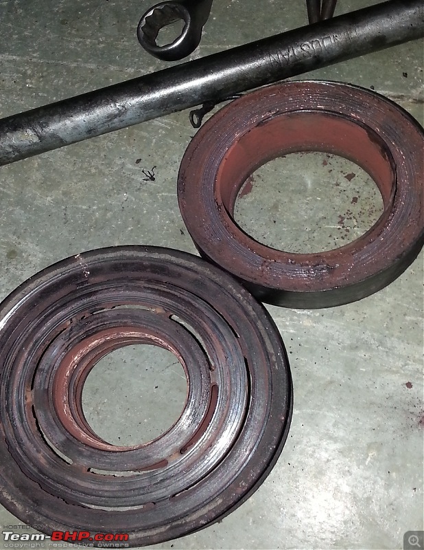

Coil inside the compressor was burnt out, hence it was shorting & blowing out the fuse. Why it happened - no one can really say, but if you recall, the illiterate mechanics in M&M ASC Sutaria Auto in Belgaum had pottered around unnecessarily with my AC compressor loosening all kinds of nuts & I suspect that this damage has happened due to those mess-ups there.
Mahindra Scorpio : Issues & Solutions-20140702_1233341.jpg
I have my Mr Reliable AC repairs man in Thane. I visited him yesterday. My first suspect was that the solenoid switch (t the compressor coil) was shorting and causing the fuse burn outs - since AC was working fine otherwise (cooling, etc). But after checking that wire, it was ruled out & the compressor coil was the suspect. Removing the AC compressor is not an easy task, but after taking it off, the coil was found to be totally bereft of enamel coating. This explained the strange plastic burning smell that I had inside my cabin last 2 days - it was the enamel burning off. The clutch plate was found to have lots of scoring due to the problems with disengagement.
Mahindra Scorpio : Issues & Solutions-20140702_1233432.jpg
We changed the coil and the clutch plate - these are easily available. When refitted back, the gas started leaking. First spit was the O-Ring in the compressor body. Then the main hose crimping was found to have gone, so I ended up changing the O-Ring, oil seal (inside the compressor body) and the hose.
Mahindra Scorpio : Issues & Solutions-20140702_1255333.jpg
Mahindra Scorpio : Issues & Solutions-20140702_1502475.jpg
