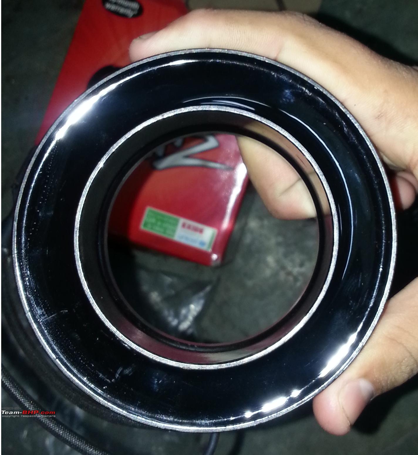

Originally Posted by hvkumar View Post
Coil inside the compressor was burnt out, hence it was shorting & blowing out the fuse. Why it happened - no one can really say, but if you recall, the illiterate mechanics in M&M ASC Sutaria Auto in Belgaum had pottered around unnecessarily with my AC compressor loosening all kinds of nuts & I suspect that this damage has happened due to those mess-ups there.
Attachment 1257196
I have my Mr Reliable AC repairs man in Thane. I visited him yesterday. My first suspect was that the solenoid switch (t the compressor coil) was shorting and causing the fuse burn outs - since AC was working fine otherwise (cooling, etc). But after checking that wire, it was ruled out & the compressor coil was the suspect. Removing the AC compressor is not an easy task, but after taking it off, the coil was found to be totally bereft of enamel coating. This explained the strange plastic burning smell that I had inside my cabin last 2 days - it was the enamel burning off. The clutch plate was found to have lots of scoring due to the problems with disengagement.
Attachment 1257197
We changed the coil and the clutch plate - these are easily available. When refitted back, the gas started leaking. First spit was the O-Ring in the compressor body. Then the main hose crimping was found to have gone, so I ended up changing the O-Ring, oil seal (inside the compressor body) and the hose.
Attachment 1257198
Attachment 1257199
Is this the component you are talking about?
It's quite a robust unit (OEM is Behr), though mine burnt out due to a voltage surge from a faulty alternator AVR.
That was my problem. Burn out of the Coil due to a earthing wire issue - the earthing wire was fiddled around by an illiterate "trained" mechanic in Sutaria Auto, Belgaum, as reported earlier
hvkumar is offline   (1) Thanks
