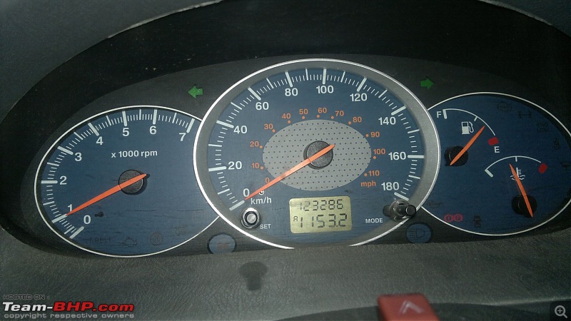

It started giving starting problems with my 2005 Non CRDe Scirpio which has done about 1.2 L kms.
Before describing the problem, let me explain the things which are done to it recently. Before that it was running with out any problem.
I have given the vehicle for 1.2 L KM servicing at Trivadrum TVS, They have changed
1) Engine Oil HELIX HX7 Diesel Synthetic Oil,
2) 105 Quick Clean
3) 107 Oil Treatment.
4) Two Bearing Idler
5) Air Element.
6) ML BR Fluid.
7) Oil Filter.
8) Diesel Filter.
Then I came to Bangalore, the very next Day. After reaching Bangalore, I was facing a Krrr, Krrr sound while pressing the clutch pedal.
Again Given the Vehicle at Sireesh, and they have replaced
1.) Clutch Driven Plate (FB810)
2.) Clutch Pressure Plate (PRODN)
3). Clutch Release bearing
4.) Crank Shaft Bearings.
Then on-wards I feel the sluggishness while starting the engine, though the Engine fired in the first crank itself, (it required a long crank). I thought it was due to the weak battery and checked the battery. Upon checking they found that there acid level is too low and they topped up the battery.
The next day when i try to crank, the engine didn't fire at all, then I push start it with the help of my neighbors. Again I have taken the vehicle to the battery shop, They told me to replace the battery ( TATA GReen 1.5 year old ). But I was feeling that it was some due to thing else. I drove around 10 kms and back. Again i tried to crank the engine, after 4 - 5 hours. It started normally. From that day on-wards I am observing that if the Vehicle kept idle around 15-20 hours, It will not start even after several attempt. Even after trying 6-7 attempts, the engine is cranking but not firing. If i push start and leave the engine running for 1 min. and try to to restart, it will start normally with out any further cranking. That means the battery is still fine. ( Leaving the Engine running for a minute will not charge the battery too much, I believe). If i try to crank again and again, every time it will fire the engine with out any problem.
Recently I have observed some more things,
1.) Even if the engine revving hard, there is no black smoke coming out.
2) The Engine Idle RPM changes from 900 to 1K after leaving the engine on for 20 mins
3.) It is taking 20 mins to reach the optimum temperature (then the RPM reaching to 1K level too) Please see the attached Pic
Taken 1min after switching on the Engine. Please look at the RPM, Fuel Gauge, and the Temp Gauge.
Mahindra Scorpio : Issues & Solutions-27062011034.jpg
Taken 15min after switching on the Engine. Please look at the RPM, Fuel Gauge, and the Temp Gauge. ( now the Fuel is gauge is close to actual reading ) ie. when the tempratures reaches the optumun level the RPM goes up and the Fuel gauge showing the actual figure.
Mahindra Scorpio : Issues & Solutions-27062011036.jpg
Please advice me to identify the problem.

Speed Gladiator, the first thing I would still try is a new battery
Styler
