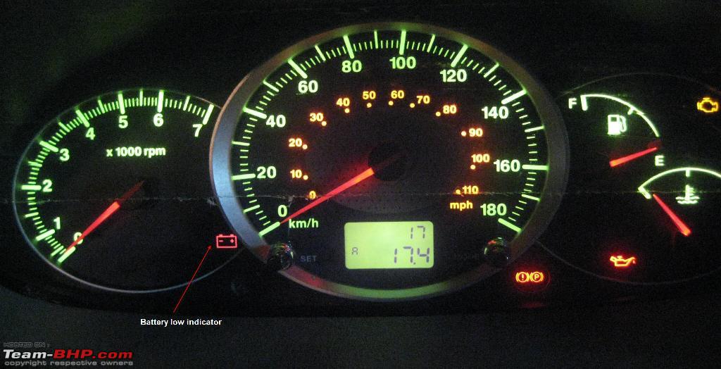

The battery low indicator has come on twice during cold starts on my Scorpio MHawk till date, in less than a month since i got it. On both occasions, it went off immediately after i drove off from standstill.
Something to be bothered about?
On both occasions, i think i had driven the vehicle through rains the previous day.

Re: Mahindra Scorpio : Issues & Solutions
On the dashboard (is there such a thing)? Or is it the 'magic eye' window you have on the battery itself?
This is the indicator i was referring to :
Mahindra Scorpio : Issues & Solutions-copy-img_1272.jpg
I also noticed today that when i press the horn for an extended beep, the sound is not consistent, and varies. Signs pointing towards a weak battery, perhaps?
Attachment 590738
That's the alternator charging indicator.
When you start up first thing in the morning, the alternator doesn't show any output because the rotor isn't energized adequately (doesn't receive enough voltage from the battery to be produce current at the rpm it is spinning, i.e. at idling). Blip the throttle to rev up to perhaps 1200-1300 rpm, and the light should go out as the alternator starts to produce current.
Doesn't indicate a low battery. I have the same 'feature' on my vehicle . IMO the alternator would need a smaller pulley to make it spin faster at idling rpm, to eliminate this issue (but this is not something that would cause any problem though).
And have the horn connections checked for loose contact - or it could be that water splash got into the horns.
