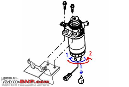

Guys, I saw the light going ON again today. The light came ON again at the same place where it was on before i.e. inside our apartment compound. What I've noticed is that it happens only when I apply brakes when the vehicle is on a downward slope. I tried reproducing it while climbing down to my parking and I saw the light coming ON temporarily again. What should I do? How do I drain out the water?
Originally Posted by kaushik_s View Post
Hi Guys, need some help here. Today while coming back from office I saw the water in fuel filter warning light going on for a few seconds. But after that it never came up again. The manual indicates that the water in the fuel filter needs to be drained and the procedure is mentioned in the self maintanance section. But I couldn't find any reference to do that. Should I take the vehicle to service center to get it done? I filled up fuel today morning only and I'm worried that due to the recent rains there might be water in the fuel. But the light was not constantly on and it happened for a few seconds (10-15) only. Should I be worried?
kaushik_s is offline
Kaushik, the process of draining out water is pretty simple.
1. Loosen the Water in fuel sensor at the bottom portion of the fuel filter.
2. Drain the water accumulated (if any) from this region.
3. Tighten fully back to its earlier position.
4. Procedure complete.
Attaching a pic for more clarity.
Mahindra Scorpio : Issues & Solutions-1.jpg
If still the light comes on, take her to the service center. Hope this helps.
Spike
