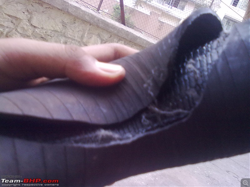

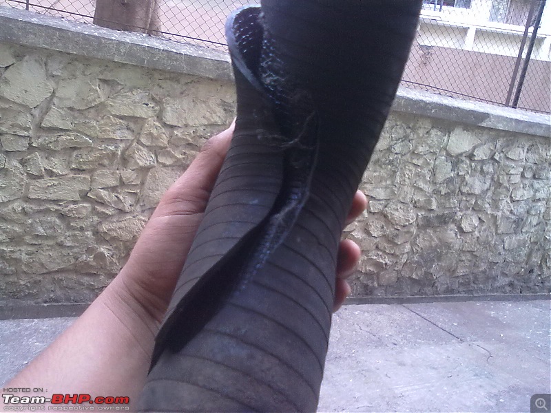

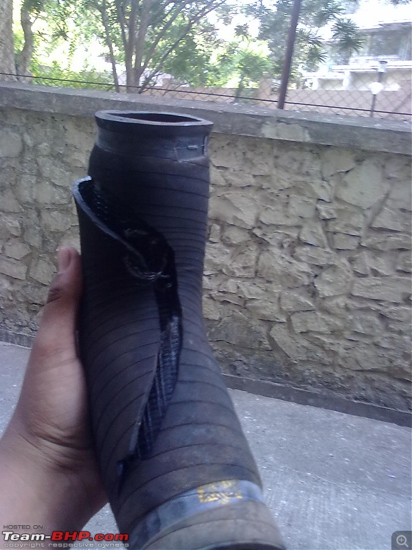

Burst Turbo system pipe
When I was driving from Bombay to Coimbatore last week, approaching Chitradurga 9 hours into the journey, I was cruising in the 130-140s when I heard a tiny "tup" noise and I felt the car's acceleration drop. There was no visible symptoms (engine felt as smooth as ever) but I was unable to accelerate beyond the 80s. My first thought was - Oh, is that a turbo problem?
But got off and first checked for tyre punctures.
Checked the engine bay thoroughly, did not find anything amiss - all wires and pipes looked OK.
I stopped at the next air puncture shop, removed the air filter and had it
thoroughly air-cleaned. Put it back, problem persisted. Rev up the engine to
2500 rpm and the engine started shuddering and losing power. I had a spare air filter, put that in, but that also did not alter things.
Found a mechanic - the M&M ASC at Chitradurga is still under construction - and we changed the fuel filters (not the M&M fuel filters though). Did not make any difference.
Checked all pipes and they all appeared to be securely fastened, so it could not be a turbo problem - or so it seemed.
I had no chance but to drive on to Bangalore which was 200 kms away. Smooth drive except that I was not able to cross 100 kmph. Thanks to a friend in Bangalore, he briefed M&M ASC SKS Auto in Bangalore and fixed up a "VIP" appointment for me there to attend to the vehicle on arrival on emergency basis (since I was proceeding to Coimbatore direct without stopping over in Bangalore).
On reaching SKS on Bangalore's Banergetta Road at 630 pm, my Scorpio was wheeled in for checks. The problem was immediately found - a burst ntercooler outlet rubber pipe. The pipe is in the bottom - and I have never changed it all these years, although I have changed ALL other rubber pipes for the turbo and cooling system - and obviously the rubber had outlived its useful life.
Unlike the "best" ASCs in Bombay (who do shoddy work and never have parts for my model of Scorpio), SKS had the part and immediately had it fixed and the way they handled the job restores a lot of confidence in the M&M service network.
Lessons learnt - when you face sudden loss of acceleration on a highway drive:
- Check if you have fuel
- Check & clean air filter, replace if possible
- Check fuel filter
- Check all pipes
I must specially commend Mr Mahesh, Deputy Service Manager at SKS who personally diagnosed, supervised and test-drove the car and got the work done efficiently in quick time. Thanks You, SKS Auto, Banergeta Road, Bangalore.
After fitting the new outlet pipe,the acceleration and power looked to be OK.......but that is another story.
Mahindra Scorpio : Issues & Solutions-21042011556.jpg

Fuel System problems
....But my problems with acceleration had not ended despite fixing the turbo system leak (which I discussed in my previous post).
After being forced to stay back in Bangalore thanks to the problem, I set off next morning for Coimbatore. I found acceleration was smooth but I did not develop speeds beyond 120 kmph and found the engine gasping when I gave it full gas especially when I was overtaking another vehicle leading to a very dangerous situation.
I could do nothing about the problem immediately, being busy with work, but I checked into TVS in Trivandrum (where I went from Coimbatore) 3 days later.
Their diagnosis was that there was definitely fuel starvation most probably due to some blockage in the fuel tank and wanted to dismount it immediately - and take 2 days of course - to complete the work. This I refused being in midst of a tour and having to leave the next day. The second hypothesis they had was that the fuel pump was defective but I had to rebut that because the fuel pump has been leaking diesel for 2 years and I have not found any problems so far because of that.
Therefore, we settled for the flushing & decarbonising routine which is supposed to clean injectors, etc. This was the quickest solution that they could think of.
All fuel lines were checked - for cuts, blockages (by blowing compressed air into the pipes) but although the flushing/decarb routine did improve matters and the engine could rev up beyond 3500 rpm, yet it did not feel smooth.
The fuel feed pipe - feeding the fuel filter - was changed (I have already changed the rubber pipe from the filter to the fuel pump earlier). And that worked - the 6-year rubber pipe was indeed the culprit and I found the accelerator pedal lighter and the power back to its old form.
The most positive fallout: the leak in the fuel pump has COMPLETELY stopped! Thinking about that, it looks that the injectors were not consuming their full quota of fuel which was obviously creating back-pressure in the fuel pump and the ensuing leak. Last 2 days, I have driven 2,800 kms in the last 2 days & 2 nights non-stop and the engine never lost its rev, I got to top speeds of 150 kmph easily and the fuel pump has stopped leaking (something which used to happen earlier on my full-speed long-distance non-stop drives).
