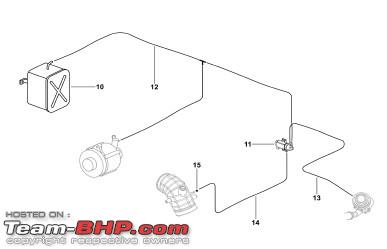

Originally Posted by hvkumar View Post
Right now, I am searching for a simple rubber tube for the vacuum system of my Scorpio. Not available.
Talking of parts not available, I have gone searching 5 cities & equivalent number of ASCs for one wheel nut!
Sir, which among these are you looking for?
Mahindra Scorpio : Issues & Solutions-1.jpg
From now on, whatever the part may be please buzz me before heading to the ASCs. I need the exact model details. You have a 2005 model Scorpio right?
Spike
Attachment 524887
Spike
PS- Which wheel nut?
13! That is the one which connects with the EGR.
Wheel Nut - that is a old story, I finally got it. When I realised it was not in stock, I specifically indented for it in the ASC. But they kept saying it had not yet come, and forgot about it. On one occasion, I raided their store, made them look up part numbers - they have this irritating habit of visually identifying parts instead of looking in the part number master - and I finally located it in the bin!!! In the meantime, I went around on a drive and checked up in other cities too without success. (BTW, this is the nut which fastens the wheel disc to the hub, there are 5 off them in each wheel).
Yes, mine is the last batch of non-crde 2005 Scorpios.
Thanks!
Please check with the ASC these parts:-
03150C0260N Hose Vacuum to EGR (01)
03150C0170N Clip Hose Vacuum (01)
Sir, please refer my signature below.
Thanks!
Let me know if this helps, or will try some other route.
Spike
