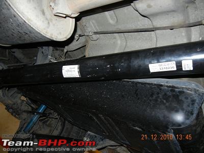

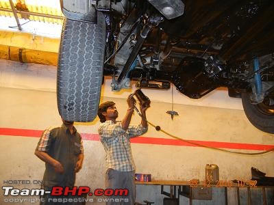

Hi,
With great pleasure from the Customer Service perspective, I would like to report my Customer Delight during my recent Bangalore Trip in my Scorpio.
As there are good number of road enthusiasts in the leadership team of my company, we all decided to drive to Bangalore from Hyderabad to open our second city Operations in India. Part of that we were a convoy of 14 cars(4 of them are M&M’s products- 1 XYLO, 3 SCORPIOs. All were my converts from other brands) who drove to Eagleton resorts(~40 km on BLR-MYSORE highway) for a 3 day leadership offsite on 16th January. When I was reversing my car to park I noticed/heard an metal crackling noise which raised my antennae up. I was tired and needed rest badly for that night and eventually got occupied with the offsite activities and forgot about the ‘noise issue’.
On Tuesday, the 18th January morning I called up my AML ASC’s Hyd Service Manager-Mr.Devender explaining him the noise issue. Devender after some investigative questions advised me on phone that I should get it ratified with local garage folks before I start back on Wednesday, the 19th January to assure that the issue is not with the differential or propeller shaft. Devender also messaged me “With You HAMESHA” mobile number, which I promptly called up and reached Mr.Kabir. Kabir patiently heard my complaint and promised to have the local BLR dealer reach me within 15 minutes of my call to him. As said, Mr.Satish of BLR India Garage Helpline called me up and after I did my explaining to him(~11 am) told me that he shall reach the resort in one hour or so. At this point, I also called Mr.K.Ravi and informed him about my problem. Ravi was very pro-active and assured me that everything will be taken care to my satisfaction.
Satish with his team mate Lokesh reached the Eagleton resort and tried to troubleshoot with out much success. They had to take my car to the ASC and their manager Mr.Laskhmipati was in constant touch with me thereafter appraising me of the updates. Apparently the star bearing/universal joint of the propeller shaft had some defect and the India Garage was forthcoming to replace the propeller shaft for me under warranty. The car was washed as a value add and returned to my on the same day night at 9:30 pm by Satish & Lokesh.
Mr.Rahul of M&M Blr was in constant touch with me through out and was following up the progress of my problem to resolution as I told them that I had to drive back to Hyd from Blr on 19th at 6:00 am. My car was delivered to me at 9:30pm with a free was thrown in.
I for sure, was very IMPRESSED with the CUSTOMER SERVICE ATTITUDE from the word go with all involved during this experience.
Great show of TEAM WORK and Customer Service. That night I took time out to explain to all my colleagues how M&M’s Customer Service helped me probably/pro-actively avoid an issue on my way back home. Also, strengthens my belief of being able to drive anywhere in India- a Mahindra!!
