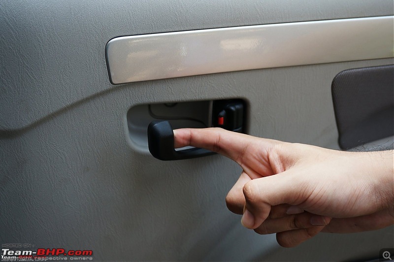

Can the new gen Scorpio be locked from inside? It automatically locks itself when a certain speed is attained, but not that.
If I get down from the car & there are passengers in the car and the air-con is running and they wish it to be locked from the inside. Any help here?

umm.. I see a toggle switch here. Doesnt that work?

I tried the toggle switch and with a lot of force, it worked as intended. But I had to apply so much force that my finger is hurting, hope it will get better with use.

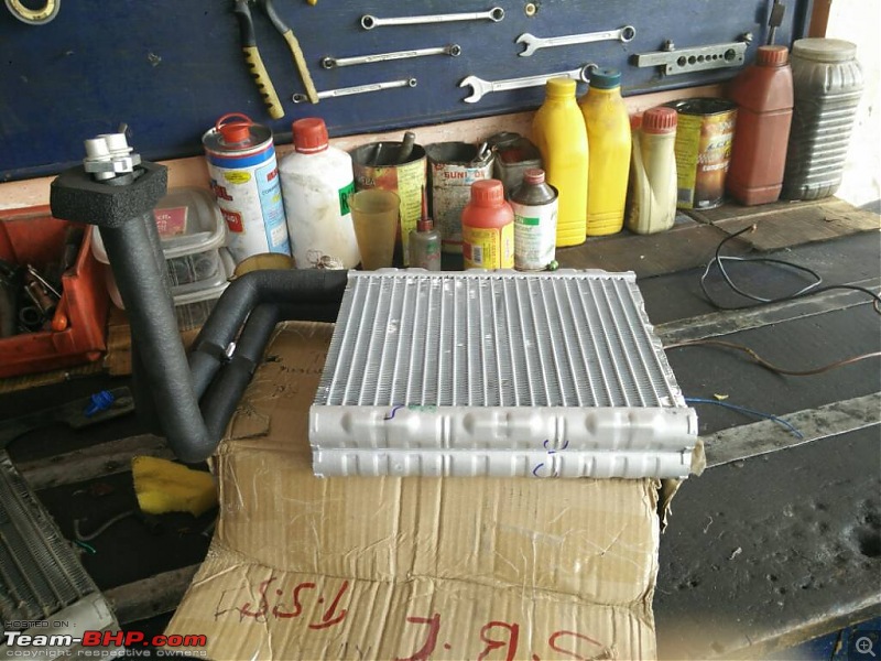

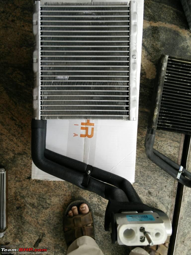

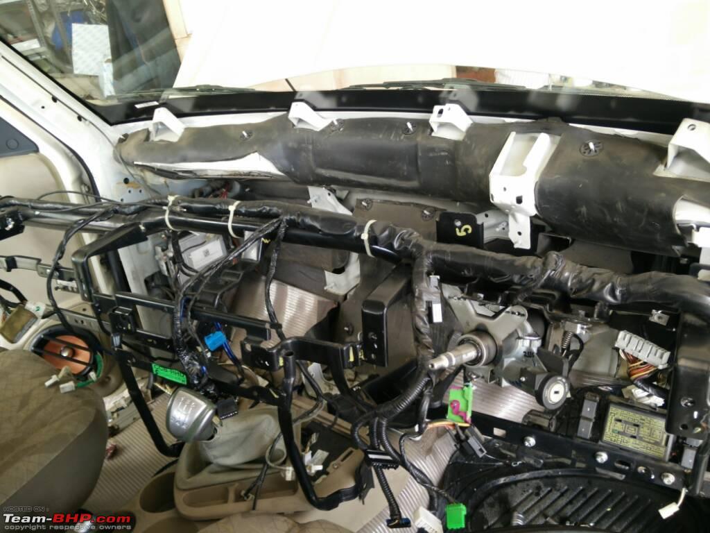

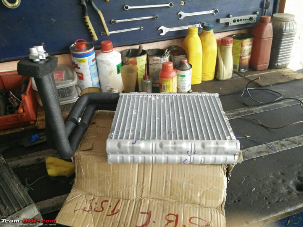

Originally Posted by shashanka View Post
Hello Dr. Anurag,
This is a new one, to be honest! I've been using my Scorpio for the past 11 years (as has Styler & I'm sure many other members too) and I've had no issues reported by the service staff re. the heater interfering with the evaporator coil, to the point that the latter springs a leak. Over the years a couple of leaks have occurred in the system (requiring re-charging of refrigerant) but the service staff did not mention the above reason.
In my experience (as a marine engineer on board ships) I have often come across leaks in piping caused by rubbing wear due to vibration - when two pipes in close proximity start rubbing against each other. This is usually the result of carelessness in assembly/layout of piping or due to careless re-assembly after an earlier repair.
I look forward to the feedback from other Scorpio owners on this issue.
Hi
I have faced same problem and got it replaced in Bangalore .
I am attaching some snaps for your reference
Mahindra charges almost 17K inr in Bangalore to replace . Got it from Dr car AC for a good price .
