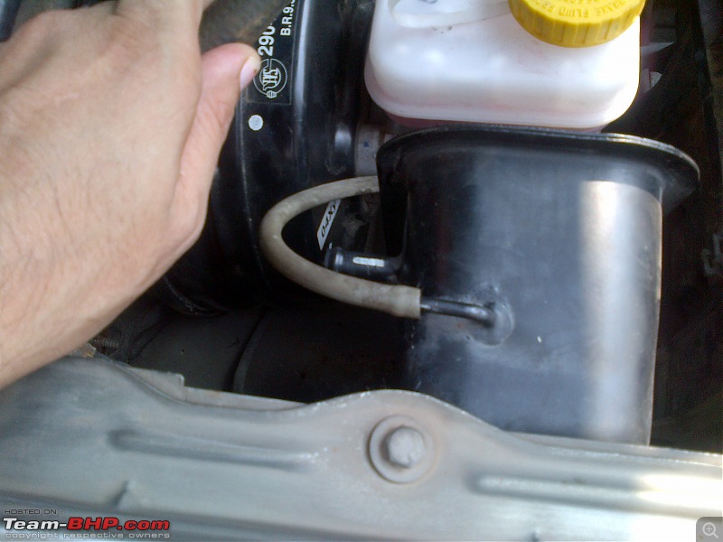

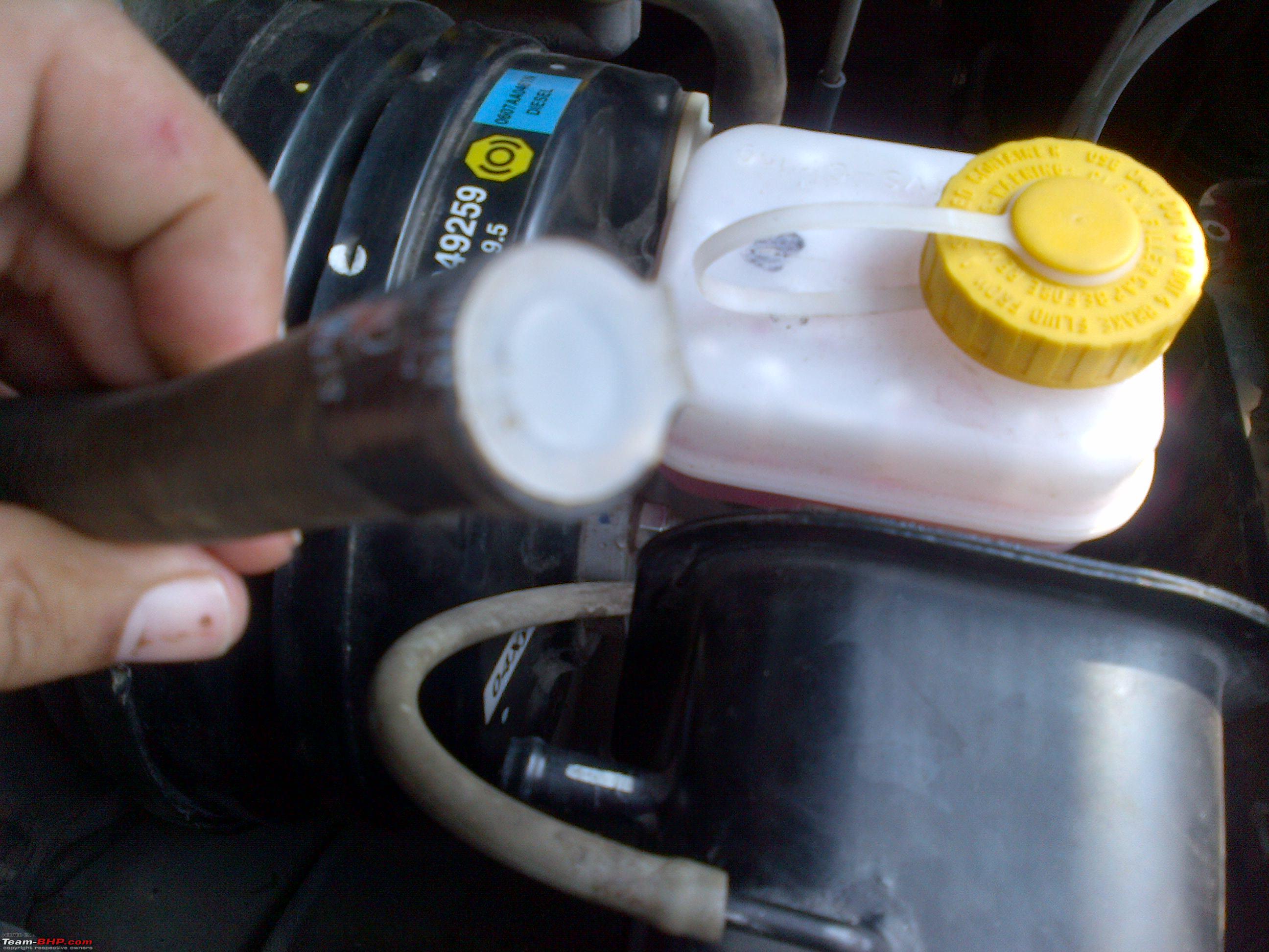

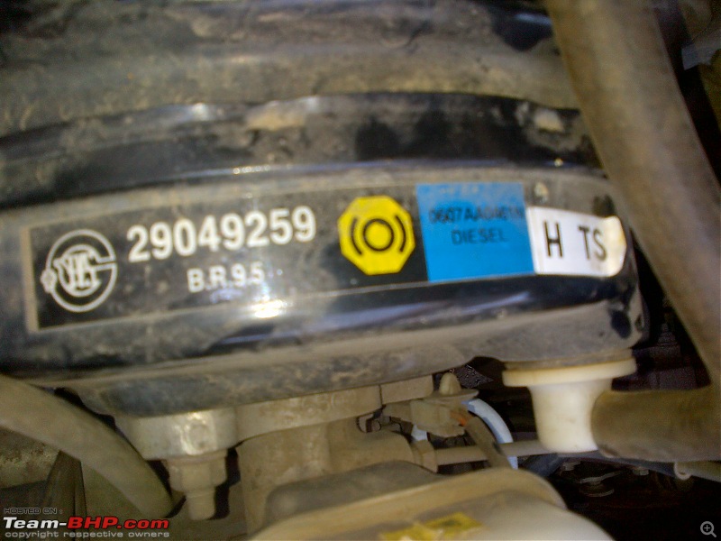

Brakes Issue
Couple of days back the vacuum assist for the brakes stopped working making the pedal hard and reducing the braking distance.
With the festival season I was unable to get the appointment to any of the safe distance M&M SS to get this checked so had to use the services of my regular neighborhood mechanic.
Initially he checked for the leaks in the lines (which I had already done) no leaks and the Vacuum Pump was working perfectly.
Then he checked the Booster and pronounced that the booster was gone and suggested replacement which was done.
The brakes are working fine but the check light has been activated.
It seems that while reassembling the lines he has deliberately disconnected one part of the vacuum hose coming from the pump and plugged it shut. (the main line from the booster pump is split in 2 parts, one goes into the Brake Booster and another into another box like part next to the booster which further redistributes it to some multiple parts across the engine bay).
When I tried plugging the hose into its correct place the brakes stop working again.
Gurus urgent help needed as I don't know which other functionality is compromised as a result of this jugad.

Adding a few more pictures and a video.
Now it seems that the vacuum box next to the brake booster is also leaking, not getting the part in the market, the mechanic is trying to source one from another Scorpio to test. Will know if it works by the afternoon.
