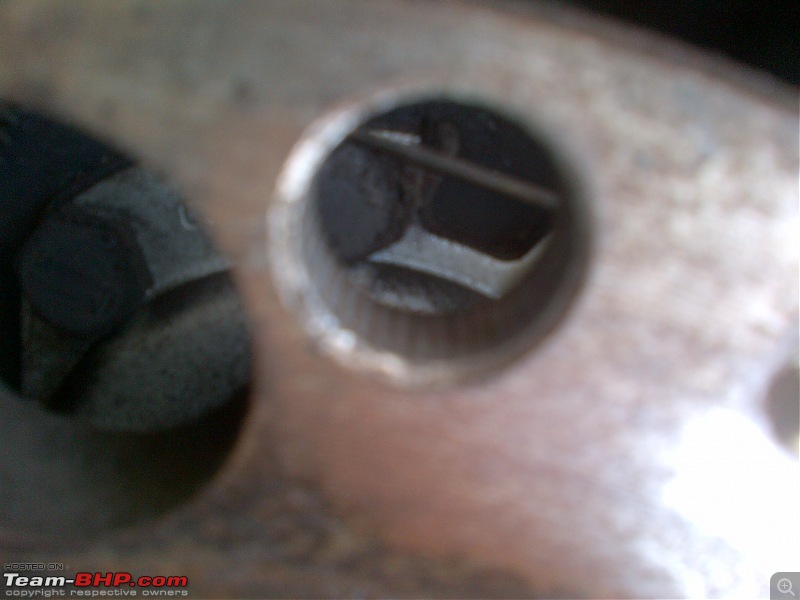

Had a bit of a scary cum funny incident with my Scorpio yesterday. The genesis dates back to last Saturday when I went off-roading with my 8 yr old and parked the car at home.
On Sunday I realized that the rear left tyre had a flat, I was flying out of town in the afternoon so I took some help to get the tyre changed and asked the person to keep the flat in the car.
I returned back early morning on Friday and planned for a shopping trip with wife and kid so proactively got the flat tyre repaired (it had a small puncture) and set out in the evening for a short trip, about 2.5 kms. from the house I felt some wobbling and then the speedo needle started fluctuating, realizing something was wrong, I immediately moved to the side an braked, the moment I braked I heard a thud and the entire rear left of the car slumped to the road.
I thought either the suspension or the entire differential had broken off, I came out and got a shock to see the tyre lying on the road and the car resting on the hub. With no clue what had happened I could see all the 5 nuts missing, and after 5 mts. of pondering a tempo walla comes and asks, "apka tyre nikal gaya kya, nut piche pare hain" (did you lose the tyre, the nuts are lying some distance away). He was a nice guy and helped me gather the nuts which were almost 250 mts away from where the tyre had come out.
I called a mechanic, being Saturday evening there was some delay so I decided to try out on my own, first I tired jacking up the other side but no avail, then the front part of the left side by the hub did not come up by an inch, so last option I managed to put the jack under the tie rod joint and managed to bring up the car and fit the wheel.
So 45 mts. lost but we managed to complete the shopping trip.
Damage:
1. One of the wheel bolts on the hub has come loose will have to get it rectified. Currently the wheel is on 4 nuts.
2. The mud flap was bent, managed to get in shape.
Gurus, please check if I need to take any further precautions / checks before planning a longer trip ( the weekend trip already cancelled as wife refuses to step in the car)

Originally Posted by m_upreti View Post
Damage:
The retaining grooves for the hub not are damaged as a result of the incident and the nut was moving free. The part is not available so have got the nut welded to the hub, will order the new hub at the A.S.S. tomorrow and get it replaced, till then I think there should be no problem with the wheel.
