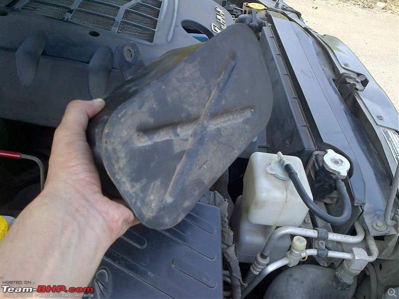

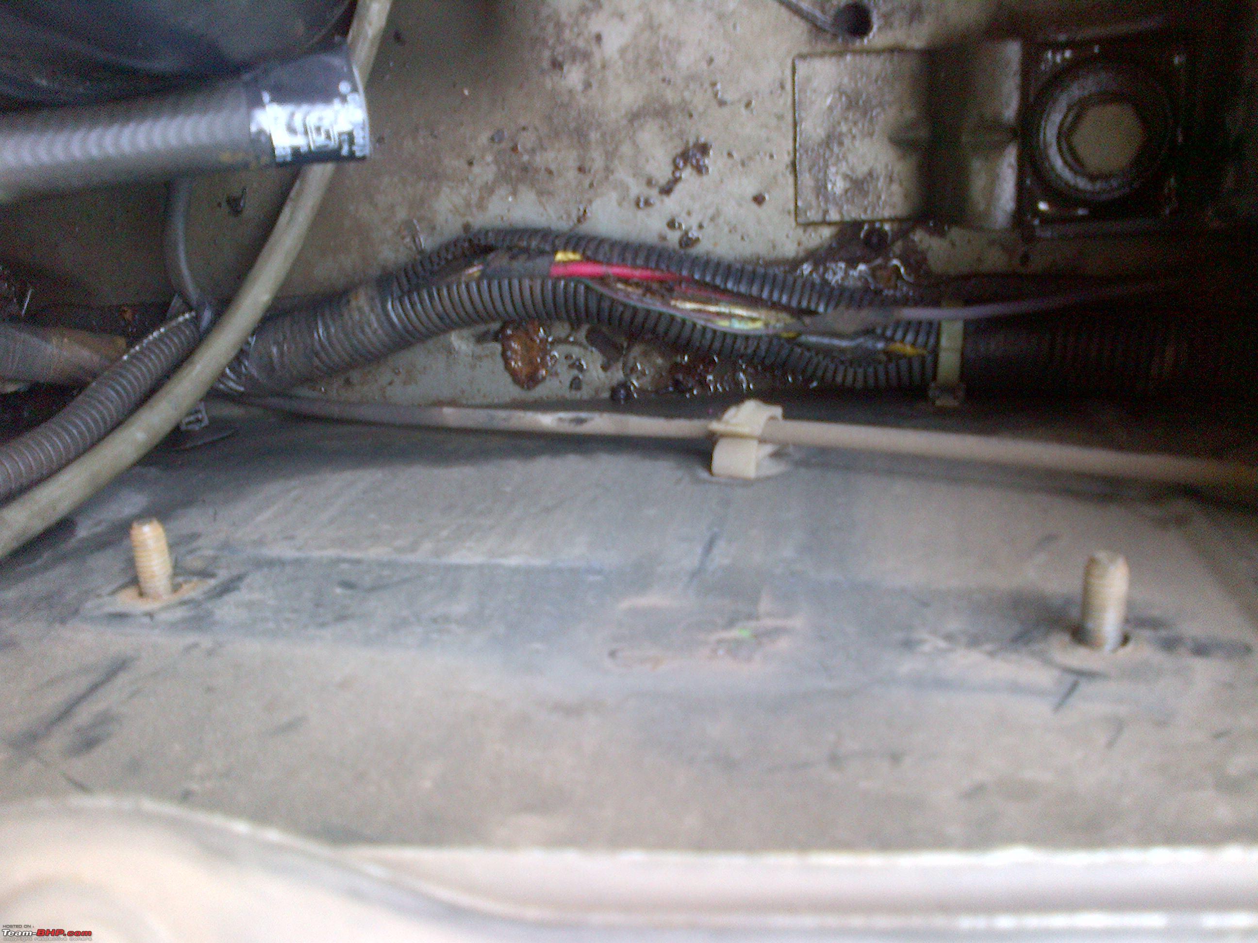

Brake Issue Identified and temporarily resolved.
Finally the issue was identified to the punctured Vacuum / air box. The said box has rusted due to water accumulation on the wire harness below it.
The part is not available anywhere in Navi Mumbai. Will have to probably go to a Mumbai SS or try my luck at the auto parts market in Kurla over the week.
Temporary jugad, is sealing through MSeal, the car has run about 40 Kms post this no issues found.
The check light is still on, will have to get it cleared through the OBD Scanner.
Had a long trip over the weekend 800 Km odd, no issues faced as far as the brakes and performance is concerned.
I was able to make decent speeds.
Somewhere over the ghats the check light went off automatically. The part (air box) is still not available, but the MSeal is holding well.
