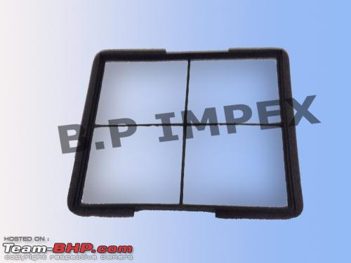

While cleaning my car, i removed and cleaned the AC mesh filter in the front glove box.
Mahindra Scorpio : Issues & Solutions-mesh.jpg
I think the particle filter you are mentioning is this:
Mahindra Scorpio : Issues & Solutions-carbon-filter.jpg
Where is the particle filter located near the windscreen. Can it be easily reached and cleaned/replaced as a DIY for 2012 LX?
Note: Images taken from internet.
