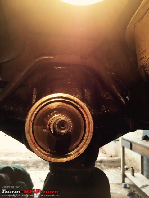

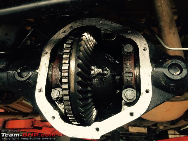

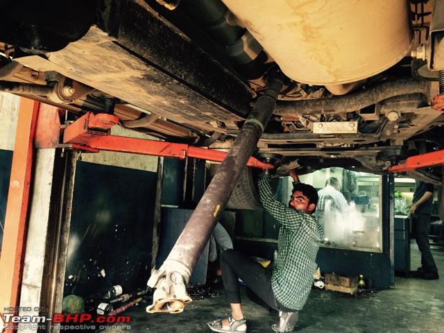

Job description:
1) Replacement of rear differential pinion seal to arrest oil leak
2) Replacement of front hydraulic damper lower bush as the same had gotten cut
Time: 2 hours
Cost: Bush ₹90, Oil Seal ₹130, Differential Oil ₹250/ltr
Tools Involved: Vehicle lift, gear puller, seal puller, combination spanners, socket spanners
FWD Differential. Dana 44. Cleaned.
Mahindra Scorpio : Issues & Solutions-imageuploadedbyteambhp1436783294.773134.jpg
Rear differential. Dana 44. After cover removal
Mahindra Scorpio : Issues & Solutions-imageuploadedbyteambhp1436783369.462185.jpg
Rear differential after clean up
Mahindra Scorpio : Issues & Solutions-imageuploadedbyteambhp1436783419.432481.jpg
Pinion link
Mahindra Scorpio : Issues & Solutions-imageuploadedbyteambhp1436783462.090534.jpg
After oil seal removal
Mahindra Scorpio : Issues & Solutions-imageuploadedbyteambhp1436783502.760914.jpg
Disconnected propeller shaft
Mahindra Scorpio : Issues & Solutions-imageuploadedbyteambhp1436783543.453311.jpg
