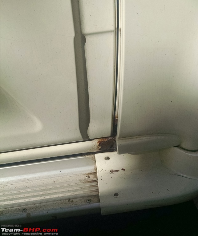

Need some help on rusting issue in my scorpio. I should say, i was bit lethargic and didnt take care of it but it has increased a bit now. Is this better to fix it in the service center or try it with any outside centers?
Mine is 2010-Jan SLE version. Is this common to get such rusting in scorpio?. Its been in chennai for all these years so not much in rain but our office is near the beach so that should have impact on the vehicle. Not sure whether this is something that can occur to all cars commonly.
Here are some pictures.
Rusting on locations in the vicinity of the sea is common but this seems to be pretty advanced, it seems that the original paint and primer layers were damaged and the rusting set in.
I am in Navi Mumbai and about 500 mts. from the sea / creek shore, but my 2007 Scorpio has no rusting apart from that on the Battery Retainers, one scuff plate and one small spot close to the running board (will share the pics tomorrow).
You better have the rusted areas cleaned and repainted before they do further damage to the vehicle.
That's where the rain water drains from the front end. You need to remove the fender and plastic cladding to look for more rust. Also remove and repair the running board.
This is caused by stagnation of mud/leaves in the gap between the fender and the inside sheet metal. Get this done ASAP. Some gas torch work with metal cutting and replacement, followed by repainting is required urgently.
Thanks!! is this better to do in mahindra service centers or try outside?
Find a local garage who are specialists in metal and tinkering work. Local garages wont burn a hole in your pocket.
Chennai is a city known for good outside mechanics and tinkerers.
Do not waste your time and money by going to the ASC for such repairs.

Well +1 here. I have a 2010 LX and have rusted in the same place and about the left rear wheel as well. I checked with a local garage and the quote is 20k with other scratches in the vehicle. You are bound to get this if your vehicle is parked in the open with rains as well.
