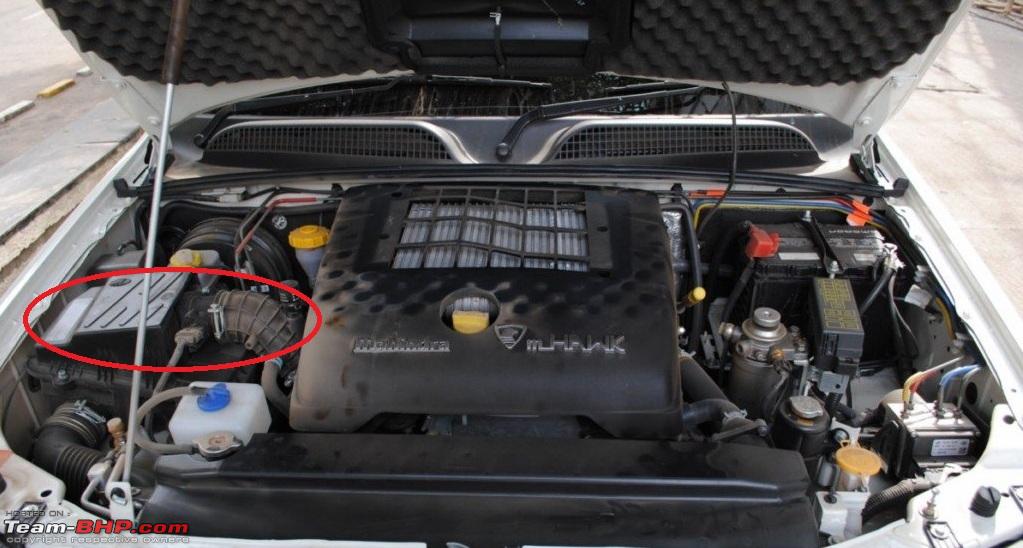

Guys, need help cleaning the air filter. I traveled through a lot of dusty roads last weekend and was thinking of cleaning it D-I-Y instead of taking it to an FNG. Any pics/guides from anyone who has done it before?

Cleaning Air Filters is not difficult.
However, Scorpios come with different types of Filters. The old-gen SCorpio comes with a Cone type paper filter where the cover has to be taken off with a star screw driver.
But the new-gen Scorpios have a different design and I found that they use allen bolts in the cover.
You can either air-clean it with you own air inflator or else take it to the nearest puncture wala, open up the air filter case & get it air-cleaned

Yes Chief, while its easy to open the top rectangular portion, the circled pipe is what I am finding difficult to open. The top cover won't come off without it.

That is just the MAF sensor, you can unclip it and clip it back on after cleaning. you can remove the hose by removing the silver clamp at the top lid end, but ensure you remove the battery negative terminal before you remove/insert the sensor plug.
That's the thing. The nut holding the 'clip' in place refuses to budge, maybe it's tightened too much. I'll try again and update.
Don't use a Philips head screw driver to remove it, I have seen that the bolt jams and the clip starts to flex. Use a T spanner or ring spanner while holding the clamp(Flat plate sort of thing) with a plier to avoid damage.
