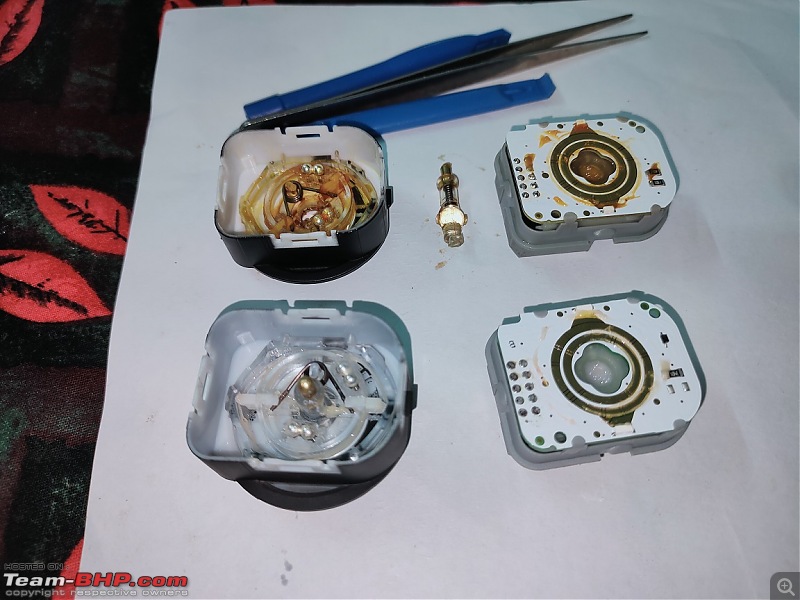

This is a follow up to my earlier post on the matter which I'm writing in the hopes that it becomes of some help to someone in the future.
After evaluating all options, I went ahead with buying the Skoda one. It cost me a total of Rs.1580/- on boodmo and reached me in 3 days. The installation was not difficult, you just have to pry a little to remove the door handle cover and then swap in the new one. Test fitting the new switch gave me great relief as all the functions worked right from the get go.
VW Polo - Maintenance and Service cost and dos/don'ts-skoda-5j5959565areh.jpg
But as you can see, the LEDs are of a particularly vibrant shade of Skoda green. We need to fix that. On to phase 2 of the plan:-
Disassembly:-
VW Polo - Maintenance and Service cost and dos/don'ts-disassembly.jpg
Old switch on top with the broken stalk for the knob and the newer one below. Both PCBs are made by TRW and appear identical. The switch is only held together by 4 clips. I used pry tools from an old phone repair kit I had laying around but any flat head screwdriver will do the job. Also, anyone attempting this should hold the switch upside down while opening it as there are a couple of small metal balls/springs that might get dislodged. Then its just a matter of fitting the top casing of the new switch to the bottom casing of the old switch having the red led PCB. This is the end result:-
VW Polo - Maintenance and Service cost and dos/don'ts-end_result.jpg
The whole thing took me around 15 minutes to do. Everything is working great and for me repairing the ORVM switch was well worth it as it saved me around Rs.3,300/- compared to the alternative.
