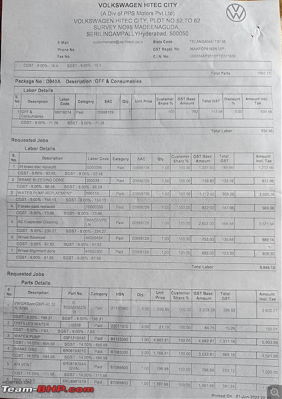

Hello All,
I have visited PPS motors, Hitech city workshop in Hyderabad for fixing the engine coolant leakage issue with my polo GT TSI. There is coolant leakage, I can see coolant on the floor as soon I start the car and a lot of noise coming from the engine bay, the service advisor mentioned it could be the water pump issue, and they would investigate and fix it. Since 75k service is due, I have asked to do the regular 75k service also. The same day he called me and mentioned that the water pump failed, it has to be replaced and also there is a lot of wear and tear on the brake discs and they have to be replaced, I said ok.
When delivering the vehicle, I was surprised to see items below in the invoice which I felt are not right for the work done.
1. Special A/C cleaning package
2. AC evaporator cleaning
3. GFF and consumables
The SA was trying to justify that the A/C cleaning package is standard for the service. I asked to call his manager, and then he consulted his manager and removed that one from the bill saying they made it complimentary now (seems they have a tie-up with 3M). But still, I'm sceptical about "AC evaporator cleaning" and "GFF and consumables" items in the bill. When asked why they are needed, he mentioned that when we replace the water pump they have to perform "AC evaporator cleaning" and it is mandatory. I don't understand why it is needed. Can you please help me clarify? Also when I asked about "GFF and consumables" he fumbled and said that it is for resetting the service, removing error codes if any and something related to the camshaft, I asked what did they do for the camshaft? He said it is related to GFF and I don't how camshaft is related to "GFF and consumables", it was very late almost 9 PM. I don't want to argue further. I paid the bill and left the workshop.
Can you please let me know what "GFF and consumables" mean, I thought the work is related to ECU upgrades and modifying existing settings. I don't know the purpose here. The SA mentioned that they did not perform any firmware upgrades. But why would they charge to reset the service?
What is "AC evaporator cleaning"? The SA mentioned that it is required since we replaced your water pump. I'm not convinced why it is needed for the water pump replacement. Can you please share your inputs here?
Guided Fault Finding.
They plug in the laptop and check for faults stored.
Did you feel anything amiss with the brakes? If not, the service advisor has successfully taken yet another customer for a ride, inching closer to his monthly target.
Your car's AC throws in chilled air through the AC vents when the blower blows air through the evaporator coil located inside the cabin, behind the dashboard. The evaporator coil can get clogged over time leading to various issues but if your AC was working fine, this was yet another unwanted job. Something you could have done yourself for < Rs. 900. And they have charged Rs 3k for this!
That's rubbish! The AV evaporator has R134a gas going through it not the coolant.
Please do not fall for all this. And if your car is out of its warranty period, please take it to a competent aftermarket garage that deals with German cars. You get better turnaround time, they don't add unwanted jobs and the cost of servicing is better (parts are nearly the same price).
Before dropping the car for every service, tell them the list of jobs that has to be attended to. Car sanitising (a new entrant after covid struck), brake jobs, evaporator cleaning, radiator cleaning, wiper changing, germicide treatment, anti-rodent treatment etc - please do not fall for all this. Your car's service manual states what job has to be done when. Just stick to it.
Thank you Gannu for your suggestions. The braking was ok but not like earlier, so I said ok for changing the discs.
I should have asked him for the list of jobs beforehand that's my mistake. I will try to raise the "The AC evaporator cleaning" item in the list with VW support.
I do think that brake parts should be replaced before any fault is felt while driving. There should be, for instance, a stipulated brake-pad minimum thickness.
I don't think that the items for each service are included in the manual any longer. This is a shame, as it enforces transparency. Stuff like AC vent disinfectant (which many of us consider useless anyway) has been adopted as "standard" by dealers.
My dealers were never too bad. They would not, for instance, replace wipers without my consent or request. I used to make that an annual event anyway, but now do it every two years.
The thing is to remember these "standard" items for next time(s) and specifically instruct not to do them. It gets written on the job sheet, so arguments, and if it does get done and charged it will be removed from the bill pronto because your instructions are clear.
I have gone independent now, because my recent service was an expensive one (timing belt, water pump, plus some other components). Next year I will probably need suspension overhaul and brake parts, so will stay independent.
It is part of the service agents job to advise of other work needed, but none of it should be done without confirmation.
