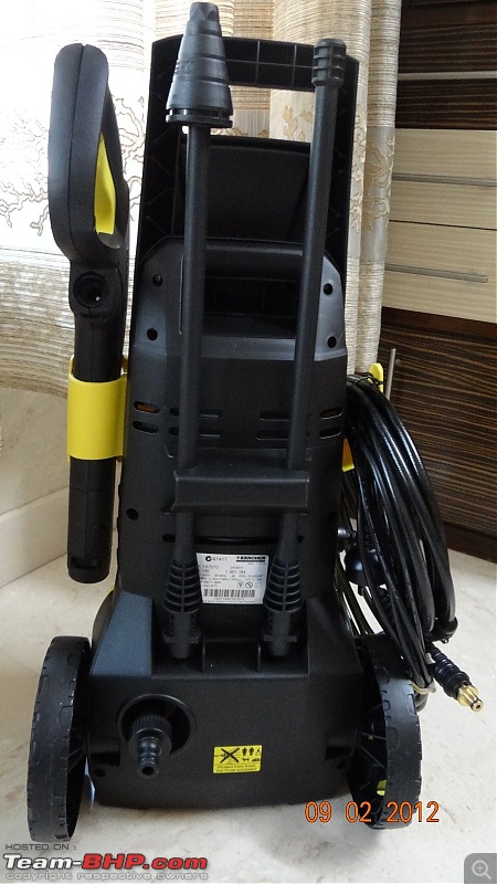

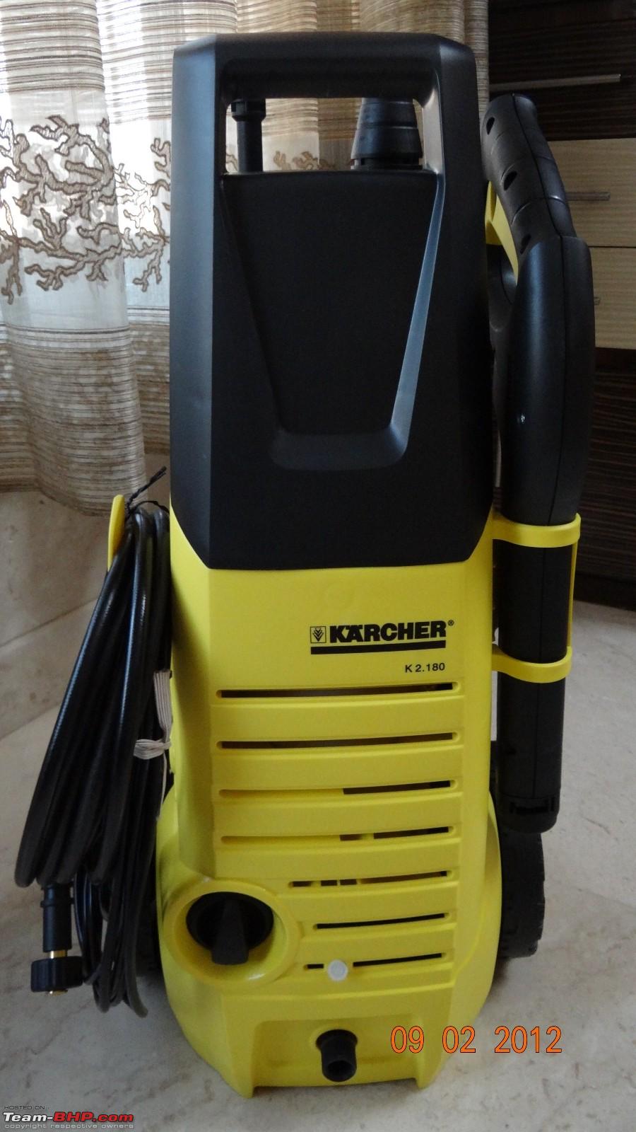

Back after an oblivion. During a recent trip to Melbourne purchased Karcher K2.180 from Bunnings Warehouse. It costed me A$135. Even purchased a few accessories for it too.
1. Karcher 0.3l Foam Nozzle
2. Karcher Water Filter
3. Hose Connector Set.
Karcher is the best one could get and the quality is good even though it is Made in China. Where I stayed at my relatives place in Melbourne tried it on their 3 cars Subaru Liberty, Honda Accord Euro and Mazda MX3 sedan. In Australia people don't wash their car that often due to scarcity of water. Karcher did a fab job. Mazda was not washed in 2yrs and after using Karcher and a bit of elbow grease it was back to its showroom condition. My relatives were impressed and they were getting themselves a Karcher too.
Only thing remaining is Torin 3 Ton jack stands to have a nice detailing on my Vento.
Here are a few pictures of the Karcher.

After assembling it all up. View from all the sides.

Super.
Thanks for the pics, when can I drop in ;) ?
Very nice-looking machine, and good accessories. I'm sure the filter will pay off, given our impure water; I got a similar for my Bosch from UK.
Let's all cry together: why are these devices so overpriced in India? :Frustrati
I'm sure yours is a higher model with better spec/features than the Bosch that paid around 8,000 for here, several years ago.
