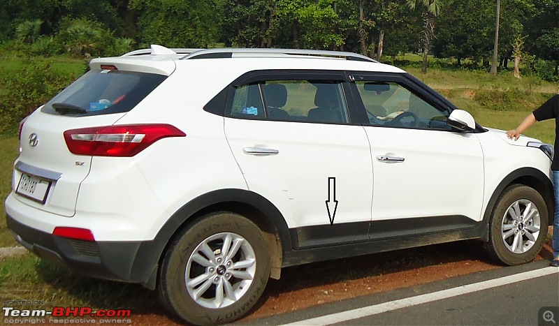

OK Guys , i do not know if this has been discussed earlier, but i want to know the best way to maintain the body cladding on the Creta. This is the portion i am talking about
Now i use the following for the rest of the car
Which one of this is best for outside cladding. Found the wax spray giving it nice and wet look but i do hope it does not harm in long run
Attachment 1448799
  • 3M Car wash shampoo.
  • Meguiars Ultimate Quik Wax spray polish for all the metal portion.
  • 3M Dash board polish.
  • 3M Tyre detailer.
use a good quality trim sealant. I use PERL for the same. I have heard gtechniq C4 is better.

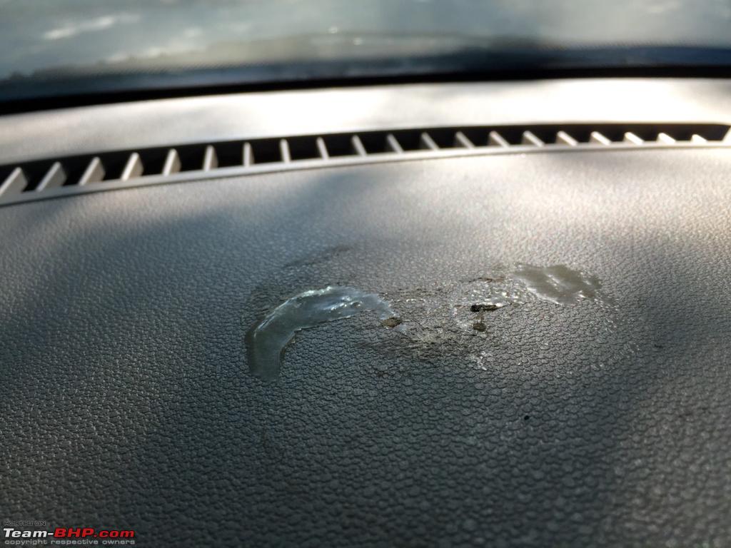

I'm at a bit of a loss as to where post this question, sorry if it is misplaced!
The dashboard of the Manza used to have an idol on top of it. Now, after the idol was removed, it left this super solidified glue (something like Araldite) that's not coming off with hot water or soap. As of now it looks downright ugly. Any suggestions on how to get rid of it?
I'll try posting a photo (I'm on the team-bhp app):
A superb Car cleaning, polishing & detailing guide-imageuploadedbyteambhp1449991852.979842.jpg
Thanks!
Try rubbing it with solvents such as acetone or ethyl acetate (nail polish remover). I had faced a similar issue in my Rapid after removing the tablet mount suction plate which left a layer of super glue. I blew hot air over the area with a hair dryer and then rubbed with acetone. It took some time but did the trick finally. :D
