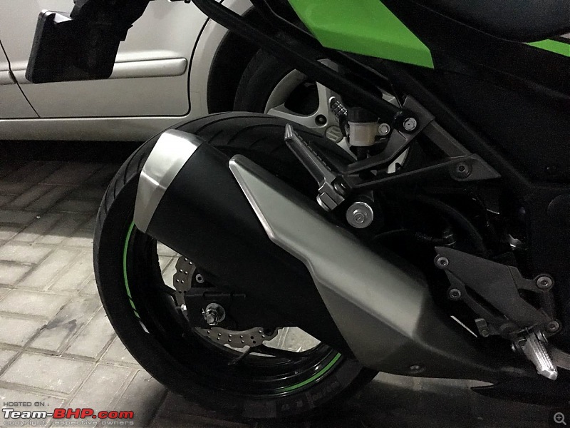

Longterm test of the 9h/Ceramic/Glass or whatever coating that I did on my bike - Impressive results, hardly any swirls and excellent water repellent effect:

More than the paint part, I am more than happy with how it keeps the plastic parts looking like new without the need of plastic dressing regularly. Here is a picture of the exhaust which is again looking like how it was on day one. A few other Ninjas I saw had greyed or whitened exhausts because of hard water scaling.:
More than the paint part, I am more than happy with how it keeps the plastic parts looking like new without the need of plastic dressing regularly. Here is a picture of the exhaust which is again looking like how it was on day one. A few other Ninjas I saw had greyed or whitened exhausts because of hard water scaling.: Attachment 1778097 |

Originally Posted by mithun
(Post 4426106)
Great coating.
1. How many months have passed since the coating?
2. How much did it cost? |
I did the coating in November. So as of June, it is eight months of use. It is as good as day one in spite of repeated foam washes, rains and wiping with quick detailer. Since I did it myself, I really didnt factor the cost of items I used out of my collection(IPA, Microfiber cloth, Polish etc). Also, I got to remove the muffler cover this weekend since the part below it was not coated. Here is the difference between the coated and uncoated areas:
