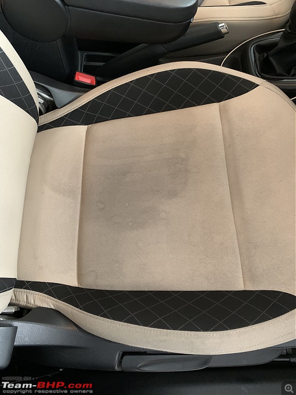

Hello all,
How does one try to keep their stock fabric seats clean?
So I have a 2020 Škoda Rapid Ambition, which comes with beige coloured fabric seats. I don’t know when or how it happened but the driver seat picked up a few stains. After looking around enough on Amazon I ordered
“Turtle Wax Quick & Easy Interior 1 Multi Purpose Cleaner and Stain Removal”
A superb Car cleaning, polishing & detailing guide-409d7ec5c4b84e49b7b88e79da68672e.jpeg

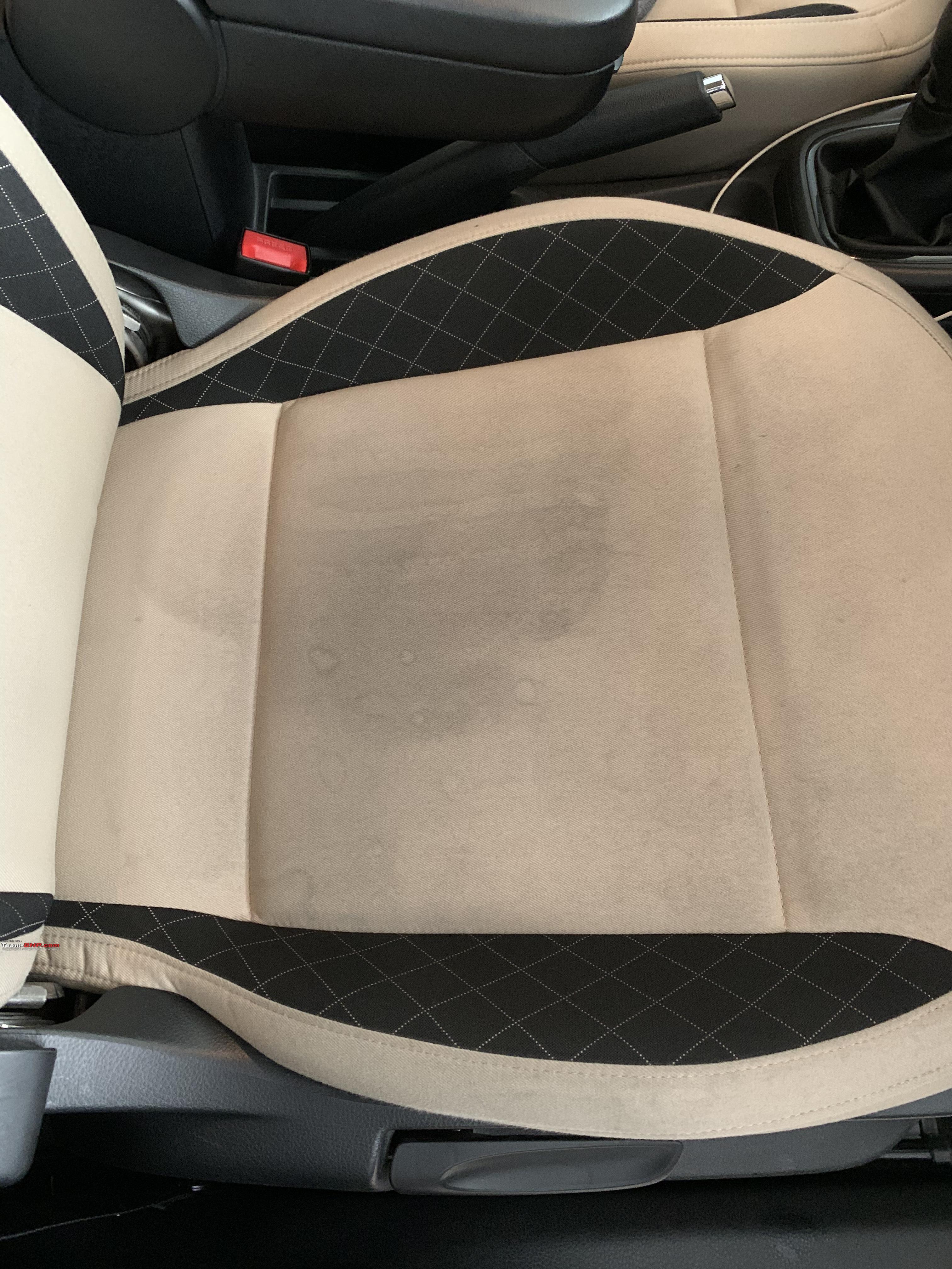

And this is the result after I tried to clean the seat base according to the video provided in product page of Turtle Wax website.
A superb Car cleaning, polishing & detailing guide-d8a6a59204594e70b0b772bbb4ee3a19.jpeg
As one can notice, the circle shaped stains were there before, now there’s discolouration. I admit it’s not totally dry yet. I tried my best to dry it with a micro fibre cloth as I do not have a car vacuum cleaner.
What am I doing wrong?
Please advice.

Are you sure you applied enough for the stain to be removed?If yes then you should wait for it to dry completely and that should lighten the stain and give you a correct picture how much effective the cleaner was.Please do keep us posted as i am also planning to try it.

I am not sure if that spot is because of the dampness or if thats because of improper process. But one thing which is very important when you clean a fabric seat especially the lighter colours is to clean the entire area. A spot fix will usually never work and will make the issue worse. In your case I do not think those spots will go once the seat dries up.
Fabric seats catch dust and store them. When you use a liquid cleaner on a small patch of the fabric, the liquid will just displace this dust and sometimes the borders of the patch will gather more dirt like a ripple effect. If not, then if you have a strong stain like ink, then when you apply a liquid soap over a small area, the ink will just dilute across the area. Hence, always spray soap and brush across an entire panel, here it is the seat base. Without a vacuum cleaner which can suck all the water out, some amount of the dirt will still remain on the area and discolouration or border marking is pretty expected. But that depends upon how much dirt was present along with the stain.
The Celerio is the only car in my house with fabric seats and I usually wet vacuum the whole seat once or twice a year. The water extracted out of the seats show how much dust was present in it even though the seats looked clean.

So the process I followed, since I do not have a vacuum cleaner:
1. Cleaned the whole seat (the base & the back rest) with a micro fibre cloth.
2. Then I applied the Turtle Wax on the whole part of seat base. Waited for 10 seconds.
3. Rubbed on the seat gently with the brush provided for over half a minute until the foam disappeared.
4. Tried my best to dry it with a fresh micro fibre cloth.
Result:
Even after it was dry, the seat base remained the same as the picture in my original post. With the existing stains, it added some more in a pattern that I sprayed the foam with discolouration.
It worked well on the beige part of the door trim in removing a stain. This wasn’t on fabric.
Mistakes I believe I made:
1. Didn’t vacuum
I believe cleaning the seat thoroughly with a micro fibre cloth will only remove so much existing dust.
2. I didn’t shake the bottle before applying the foam, thus the foam didn’t spread in the y-axis but spread in a z-axis on the seat base.
You are right. I have watched several videos from Ammo NYC & Chrisfix before deciding to get this product & have a go at it myself. These guys make it look so easy, even with all the information they share & with all of the precautions, something is always amiss & I made a mess of it.
My questions to the experts
1. Do I try again with the same product?
2. If yes, then any changes in the procedure, without still possessing the vacuum cleaner?
3. Or just leave it as is & go ahead with getting seat covers? As I planned on getting them once I get rid of the stains.

I would suggest not using the same product again as it will spread the stain even more. From the looks of it, the fabric is holding too much dirt. My suggestion would be take lukewarm water in a sprayer bottle, put 5-6 drops of prill liquid or any APC in it, spray on to the seats. Use an old toothbrush to agitate the surface. Once done, use a wet vacuum to suck out the water from the seat. As you don't have a vacuum cleaner with you, use as many dry microfiber cloths to press and wipe the water out. You might have to repeat the process with just water after that to remove any remaining dissolved dirt
