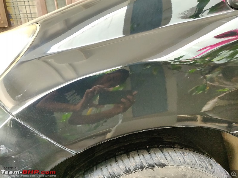

Our family also owns a used and abused 3rd owner 2013 Amaze that has more pinholes on it's paint than parts in the car.
It has quite a few scrapes and dents. Paintwork is also not much cared for so it has it's fair share of scratches.
I had borrowed a rotary machine from Sai_Sailendra, you might know him from his magnum opus of a thread linked HERE.
Spent a weekend at my relatives place where the amaze is kept, and coincidentally I was carrying the Rotary, Cutting compound, Finishing compound and some pads in my Safari .
Decided to experiment on the Black Honda Amaze.
This is how the aged and tired paint was looking earlier. Also notice the BIG scrape . Luckily it was in the clear coat itself.
Didn't wash the car or anything. Just washed that one panel with a wash mitt and got to compounding it. Used a Rupes Foam pad. And WaveX cutting compound.

Once all the scratches were gone in the compounding step.
The cutting compound had rid the paint of defects and scratches but had left the paint hazy. A somewhat milky look. It's how it works. This is where the polishing step comes in.
Switched to a large foam pad that was softer than the older rupes pad and started polishing with Menzerna 3000.
Once I went over the entire panel with that. The results were simply mind blowing. I never in a thousand years expected the Amaze to have such good looking paint.
