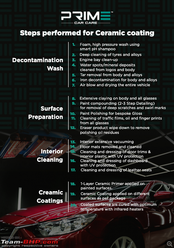

Thank you so much. I think I will go ahead and get the coating done, specially cause of UV protection as my car has an open parking.
Is that CarPro or Capro is a separate brand? (I couldn't find capro though).
I actually have a vendor whom I spoke to regarding Ceramic and they are the official partners of Carpro as well!
These are the details they shared if anyone else is also interested.
A superb Car cleaning, polishing & detailing guide-screenshot-20240416-6.56.488239pm.png

Originally Posted by DrViz_26 (Post 5753799)
Thank you so much for your reply.
As I mentioned - redirecting the PPF budget to invest in detailing products. So suffice to say - a lakh.

My bad, typo. It’s CarPro, and CQuartz Pro and Finest are both great options.
It’s weird that the installer only offers side glass and sunroof coating on the highest possible option, what if one wants CQ Pro + all glass surfaces coated? Once you drive a car with coated glasses you’ll never go back as wiper use is nearly eliminated during rains.
Ensure they coat the ORVM’s as well with FlyBy30 as it’s not mentioned anywhere but it’s critical to the full experience in case you’re going with glass.
Also strange pricing, larger cars don’t take up 70% more product/effort/time than smaller ones. 20-22% at best.

Totally agree with your thoughts about PPF. I will talk to the installer and see if I can get a better deal.
But to be honest, I have been really fascinated by SOFT99 Ultra Glaco and Glaco compound. Read about it in this forum many times and saw so many videos. Seems like it is possible to do it DIY and the result is pretty awesome. Also, available on Amazon at a reasonable price too. Didn't find it being offered by anyone in Kolkata.
Do you think FlyBy30 is better than Glaco? Well, if I will be getting a CarPro ceramic coating, getting a FlyBy30 from the installer will make more sense as they can cure it using IR blasters.
A silica based ceramic coating intended for glass will be more durable than any polymer based coating, be it Glaco or RainX. With the latter the claimed durability is in months, whereas with ceramic based glass coatings, it’s in years.
Now I’ve not personally tested either and neither is Carpro forthcoming about FlyBy’s exact chemistry, best to ask your installer.
Silica based coatings are as easy to apply on glass as RainX or Glaco, no increased difficulty. Prep is everything so ensure you clean, clay and polish (if needed) to deep clean the glass surface before application (whatever you’re applying).
In the words of the great Yvan Lacroix, IR lamps are just slick marketing, heat is not required to cure a ceramic coating, its humidity. I will agree with him here, what determines curing and flash times with ceramics is the ambient humidity, not heat.
(Having said that, I’m aware a certain minimum temp is needed to apply a coating successfully, under 2 degrees Celsius and you’ll have issues but no one’s really working in the open in winter anyway.)
